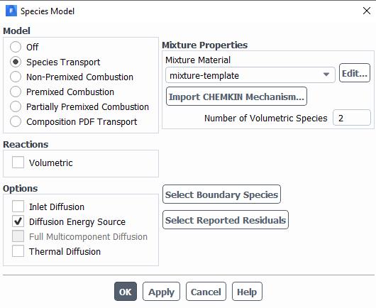

      we are simulating a multi species setup in our case. we have a room where the Supply volume flow rate is 10360 L/S. our extract volume flow rate is 9320 L/S.  this is a fish selling shop. the main objective of this simulation is the maintain the Fish odor ppm in the desired level such that the people wont feel the fishy smell. we have enabled gravity, we have incorporated air and Trimethylamine as the mixture template in our case. Trimethylamine is the species which is emitted from the fish. this species causes fishy odor as per a lot of articles.

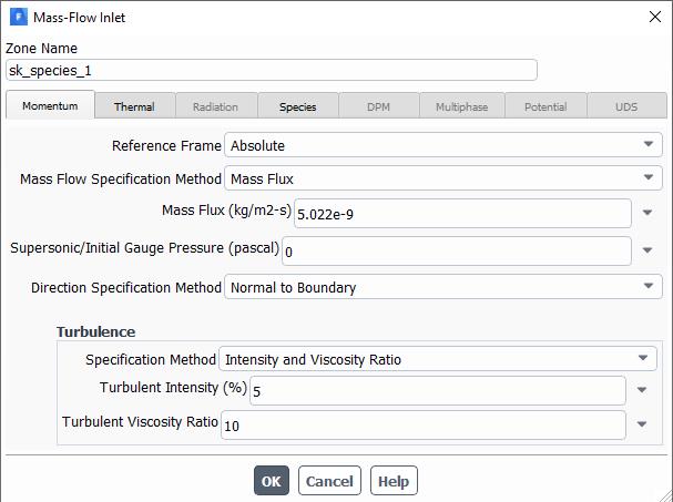

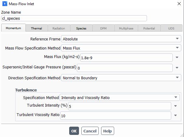

      all the inputs related to source generation rate of TMA from fish from each selling Kiosk are provided (KIOSK= at this place the fishes are placed).

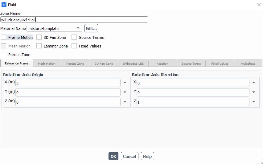

      Looks OK for a species model. I assume you also have pressure bc's and aren't using fixed flow inlets and outlets? Is gravity defined in the correct direction?
      For HVAC I prefer Body Force Weighted,
      Run the model and then ask questions if the results aren't as expected.

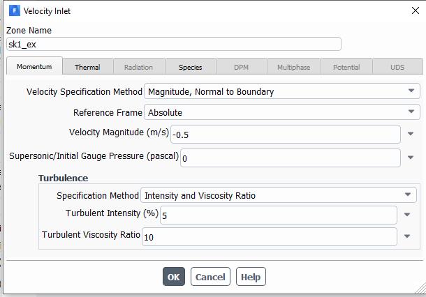

      Just to add to what Rob is saying - why are some of your velocities negative normal to the boundary? Is this something intentional? Are you imposing a specific velocity as an outflow?

      Thankyou for your quick response. as per the initial design from the client there is a mass imbalance in the current case. so in order to maintain mass balance we have considered 3 door openings as leakages for remaining flowrate to go out from the domain. these 3 door openings are considered as pressure outlet boundary conditions in the model.
      inshort we have velocity inlet boundary condition for volume inflow.
      we have velocity inlet with negative sign at velocity outlet boundary condition.
      the remaining flowrate is sent out of the domain by using pressure outllet bc along three doors.

      It is fairly unconventional to use negative velocity at the outlet to prescribe a certain mass flow rate at these boundaries. But, if this is something that you need to impose in order to close your problem properly, please go ahead and do that. Since you have more than one outlet, perhaps, it is okay to do what you're doing.
