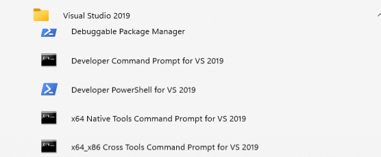

      Hello
      1. There is a built in clang compiler which can be used
      2. if an external compiler needs to be used, then try starting Fluent from the x64 Native Tools Command Prompt or similar option in Visual Studio 2022
        here is an example showing Visual Studio 2019
