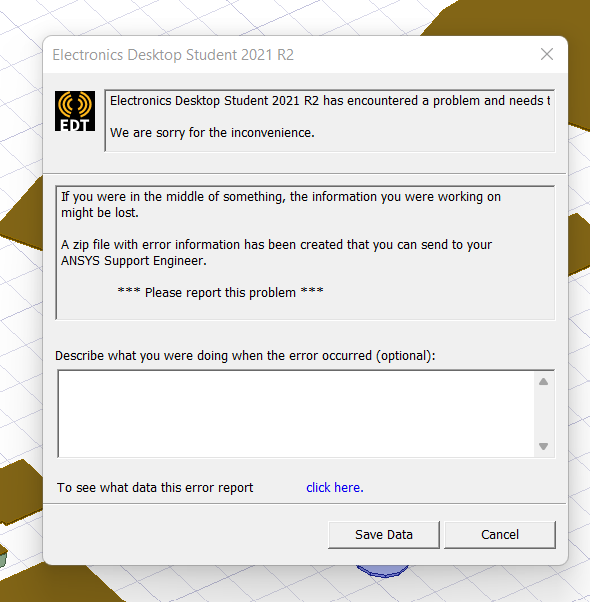

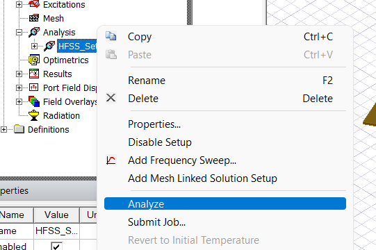

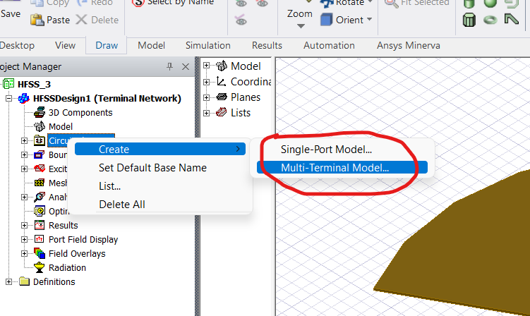

for my bachelors thesis I use Ansys Electronics Desktop 2021 R2. Everytime when I try to create a circuit element the software crashes. The same happens I try to run a Analysis.
Are there any known fixes for this problem?

October 25, 2021 at 5:42 amostahos
when I try to create a circuit element with one of the buttons, ansys crashes.
Also when I try to Analyze the model Ansys just stops working.
I know that the project files must be ok, because on a regular Ansys version everything works as expected. On a different PC with the same Ansys Student version, it also crashes.
Thanks!
October 25, 2021 at 10:18 amPraneeth
Bbp_moderator
Please note that AEDT student version does not support Circuit capabilities. More information about the student version are available here - Ansys Electronics Desktop Student Version | Free Software Download.
It might be the reason for the crash.
Best regards.
