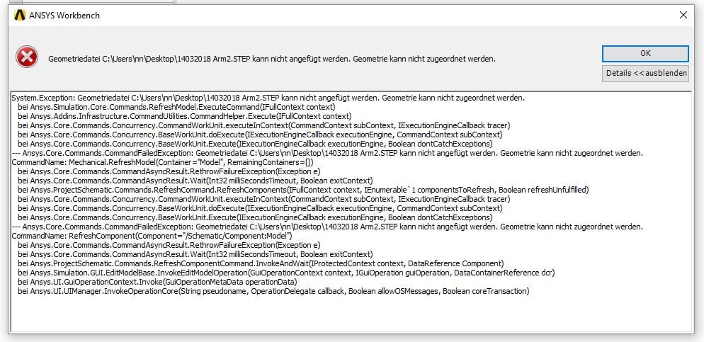

I'm new to ANSYS and have recently installed Ansys Student 19.0 (Win10 64bit). I would like to open my SolidWorks files in Ansys. When I try to do so there are a lot of error messages popping up. It doesent matter if I take a *.step-, *.igs-, or a *,sldprt-file to open. Please have a look at the attachements for more details.
Thanks for any help.

Ansys EmployeeIt opens perfectly in my 19.0 version. Try to open SpaceClaim or DM first and then import geometry.Â

thank you for your comment. Unfortunately this wasn't the solution for my problem. Spaceclaim opens my SolidWorks-file, but i can't save it. It seems to be to big. Can that be the problem? My model has less than 300 areas, but where can i check the number of bodies? ÂI have changed the language to English. Now its easier to talk about the error messages.

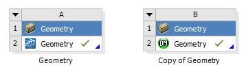

One way you can count faces and bodies is to duplicate the Geometry item, then open it in DesignModeler.
DesignModeler has a summary for a part.

luckiliy I could fix my problem. The solution was to prepare my files with the repair-tools in Spaceclaim. For some reason it looked like my files have to many bodies/surfaces. Now I am able to open it in Ansys (:
