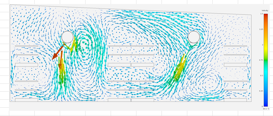

1.) Can I use the "Cut" function with vectors.
I see that you can use the cut function with contours but with vectors it is grey for me. This is the most useful result for us and we use it in AIM. Is there is way to replicate it? I attached a picture of an AIM result that I am trying to replicate.
