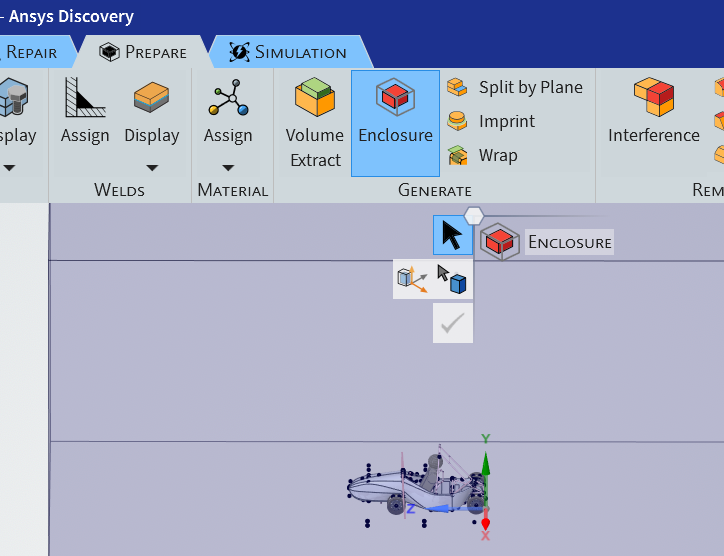

Dear Ansys team and fellow users,
On certain functions, in this case using the Enclosure tool. I need to make an enclosure for CFD simulation. Using Solidworks 2024 Assembly document (.SLDASM) However, after inserting the enclosure dismensions in and clicking on the green arrow, the loading circle mouse icon appears, and it doesn't seem to be able to 'unfreeze' itself. Tried 3 times, without any success. Had to force close Discovery via Task Manager.p>
Other functions, such as using the Interfence tool, it takes a long time for the loading mouse icon to disappear. Other function is using the pull tool to give body panels of my car some width, it's very laggy.
Overall, I find Ansys discovery slow.Using Ansys 2024 R2 student,

May 8, 2025 at 12:27 pm
CFD_Friend
Ansys EmployeeHiÂ
This can be due to the complexity of the geometry or if the geometry has errors. Please check if the geometry has errors using the check geometry tool. You can use the shrinkwrap tool to reduce the complexity of the geometry.

Note: UPDATED I figured out what went wrong! (See below)
Hi CFD_Friend,
Thanks for helping!I have used Check Geometry, and shrink-wrapped on the one of the body panels that was displaying geometry errors that I couldn’t get rid of (Currently 2 geometry errors total on that one body panel), and used shink-wrap on the whole nose, being a complex part.
I have made the nose uniformly smooth (and made in solid) in Solidworks before importing into Discovery, more smooth compared to my first version (where I tried to make the body of the nose solid using the Discovery’s Pull Tool, and I wasn’t able to offset each sub-face of the nose equally outwards)
However, I am still not able to make an wind-tunnel enclosure.
(I have followed the tutorial until the making of the enclosure in Lesson 1 Part 3, except for the MRF of the wheels (for now), and have skipped making the tyre patches (for now) as shown in the tutorial Lesson 1 Part 1 video as I don’t thing they’ll affect the success of the enclosure. I also have not solidified the air between the rim and tyres,as I couldn’t figure out how yet . )
Also my body panels are not perfect aligned (there are gaps) as this is just a 1st iteration, and not ‘water tight’.Questions:
Would a non-water-tight body affect the generation of the wind-tunnel enclosure?
UPDATE:
I figured out that air between my rim and tyres causing the issue of wind-tunnel enclosure generation, as I was able to generate it without tyres in my simplified FCM.
As above, I still haven’t figured out yet how to fill the inside of the wheel in Ansys Discovery.
But I have solidified the inside of the wheel with Solidworks (I still want to know how to do it in Discovery).
I tried with just one wheel assembly (tyre + rim) to make an enclosure around itself, and it worked for hollow and solid wheel. But with solid wheels (x4) in the FCM, I can’t generate an enclosure around it. (The solid part of the inside I made is not perfect, and intersects a bit with the tyre geometry. (Although if 1 of my single wheel can work, why can’t x4 with FCM?)ÂUPDATE 2: I skrink-wrapped my wheels on my FCM, and it worked!Â

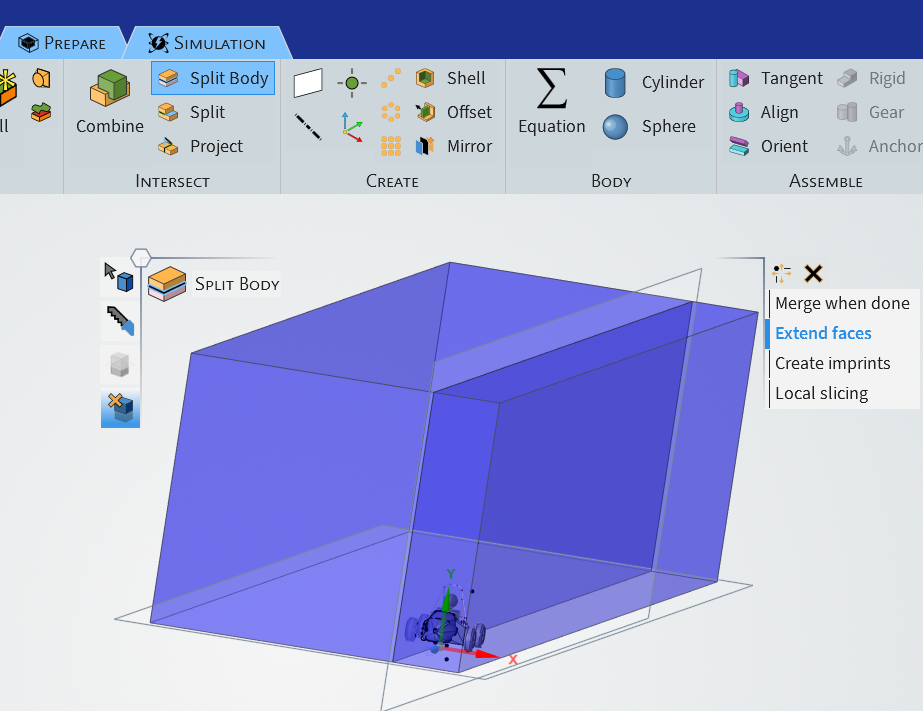

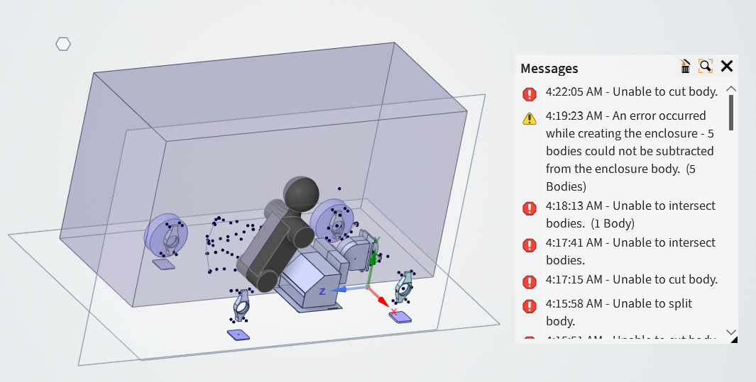

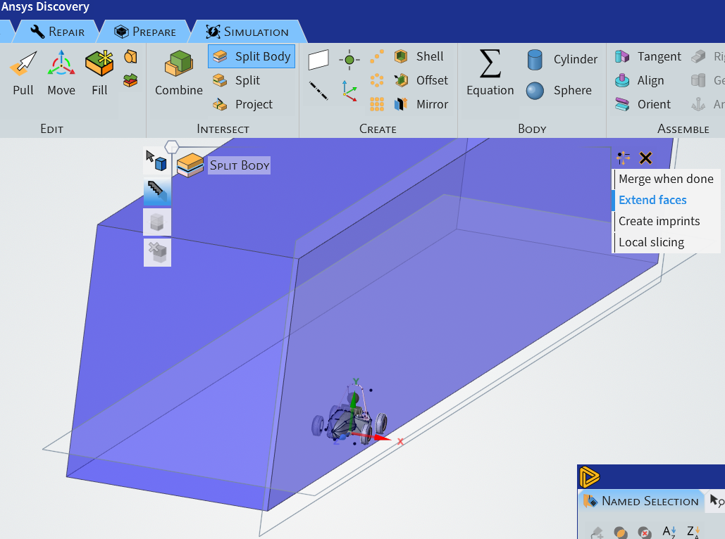

I’ve run into another problem:
Following Lesson 1 Part 3, I’m having trouble removing the right side (looking forward at the car) of the car when selecting the right side of the enclosure to cut out (in the video, the tutor refers it a the left side), using the Combine/Split Body Tool.
Happens in SpaceClaim program too.Only the enclosure disspears when I perform Spilt Body.
What could be the issue?
My CAD assembly wasn't optimal in terms of Ansys-friendly, so I got rid of all the possible components that was/or could cause issues, and tried to split, however an error message appeared "Unable to cut body".
Thanks again.
