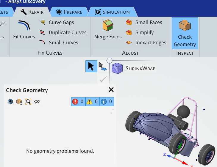

This can be due to the complexity of the geometry or if the geometry has errors. Please check if the geometry has errors using the check geometry tool. You can use the shrinkwrap tool to reduce the complexity of the geometry.

Thanks for helping!I have used Check Geometry, and shrink-wrapped on the one of the body panels that was displaying geometry errors that I couldn’t get rid of (Currently 2 geometry errors total on that one body panel), and used shink-wrap on the whole nose, being a complex part.

I figured out that air between my rim and tyres causing the issue of wind-tunnel enclosure generation, as I was able to generate it without tyres in my simplified FCM.
As above, I still haven’t figured out yet how to fill the inside of the wheel in Ansys Discovery.
But I have solidified the inside of the wheel with Solidworks (I still want to know how to do it in Discovery).
I tried with just one wheel assembly (tyre + rim) to make an enclosure around itself, and it worked for hollow and solid wheel. But with solid wheels (x4) in the FCM, I can’t generate an enclosure around it. (The solid part of the inside I made is not perfect, and intersects a bit with the tyre geometry. (Although if 1 of my single wheel can work, why can’t x4 with FCM?)ÂUPDATE 2: I skrink-wrapped my wheels on my FCM, and it worked!Â
