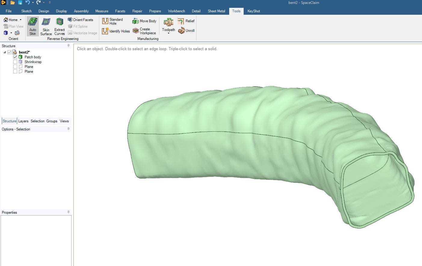

SubscriberI am new to ANSYS and I am trying to do airflow simulations through a tunnel section
. Point cloud data converted to STL in another program then STL to CAD (.scdoc) in SpaceClaim. The problem comes when I try loading the .scdoc file into Discovery it says "error loading file" and I have no idea why because the same file loads perfectly fine in SpaceClaim. I appreciate any help.

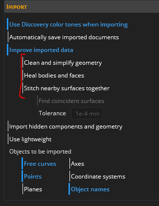

Discovery supports import/export of different CAD file formats. Bringing the CAD directly to Disocvery might help reduce such errors. Also, Disocvery has import options like clean and simplify geometry, heal bodies which tries to fix the geometry errors during import.Â

Could you please instruct how to get that 'import' menu? I can't find it in the settings.

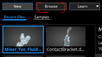

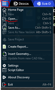

You can either import the file from the File menu>Open option shown below or from the Home page you can use Browse to import CAD files.Â
The File Options settings can be found here:
