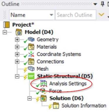

SubscriberHi guys,
does anyone know where can i change the analysis setting to direct solve in ansys ? thank you
February 8, 2020 at 7:23 pm
peteroznewman
SubscriberIn Workbench/Mechanical, under Analysis Settings, there is a line item for Solver Type.

chinguanwei
Subscriberhi peter, thank you I managed to find it. After i tried changing to direct solver. the stress was about 90Mpa then i decided to add a 0 displacement ( y and z) at the vane tip. However the stress become 400 MPa.
Is there anything that i also need to change when i use direct solver? In addition under the geometry, i realise i have a cross "Vane 0 left together". Is there any issue or is perfectly good since geometry is tick
