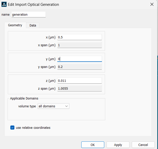

However, when I import the resulting
.mat
file into the CHARGE solver:The "generation" object appears as 2D (rather than 3D), my simulation region of CHARGE solver is 2D with Y-axis normal.
And the Y-span is shown as only 0.2 µm, even though the FDTD region spans 1 µm.

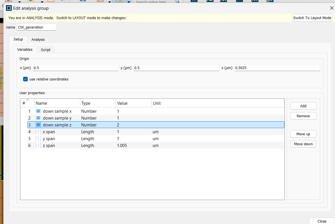

 fig 1. Monitor setting of charge generation in FDTD
Fig 2 geometry of generation monitor because of imported data from FDTDÂ

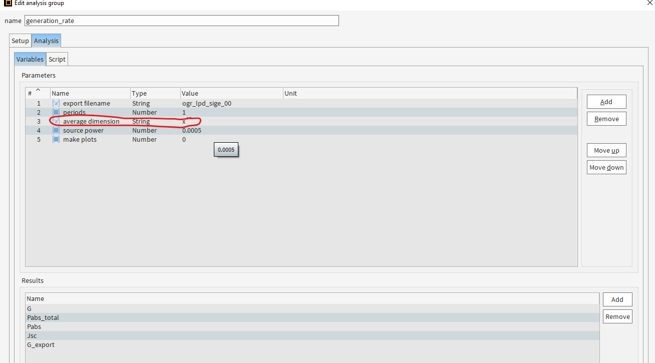

I would recommend looking into the vertical photodetector example simulation files which exactly uses the analysis group in FDTD to export the generation in the correct format to a MATLAB file, which then can be imported into a 3D generation object in CHARGE. this approach for importing the generation data into CHARGE. Normally, if a structure is uniform along its length, the 3D optical generation rate from FDTD is averaged along the length, which allows doing 2D CHARGE simulations, significantly reducing simulation time. For your case you should avoid averaging this dimension. Thus, you should choose the "average dimension" to set to "none" in order to omit averaging one dimension of generation rate and produce a 2D profile.Â
