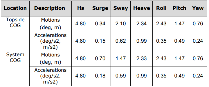

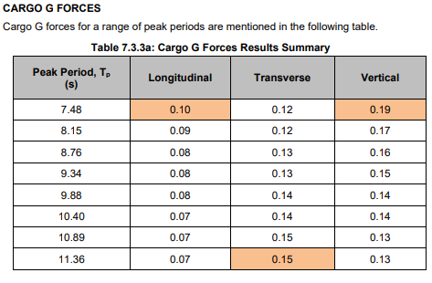

SubscriberHi here I have several related question regarding ansys aqwa,
- after solving hydrodynamics motion response, where can i get node motion for 6dof.
- I need to input wind and current coefficent, but how do i key in, appreciate if you can clarify how to get the force coeffient and what formula used in aqwa?
- Appreciate your kind support, refer attachement for details. Thanks!

Ansys EmployeeHi, regarding your questions:
- you can define the node as a connection point of the structure (right-click on the structure/Part under the Geometry branch in the Outline tree > Add > Connection Point), and then in the Details panel of the Structure Motion result, change Reference Point to the Connection Point you define.

- Aqwa provides gravity force, acceleration, joint reaction force, and fender forces results, which can help you calculate g force depending on how you model.
Hope this helps.

SubscriberDear Yu Bi, tahnks for the clarification, does this will be reporting in LIS file as well? Under what section
December 22, 2022 at 6:18 pm
Yu Bi
Ansys EmployeeThe nodal motion will be reported in the LIS file if you select Yes to the Include in Results option in the detail panel of the connection point. It is usually in the last part of LIS file within each step time history results.
