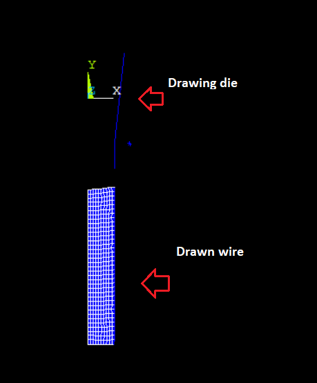

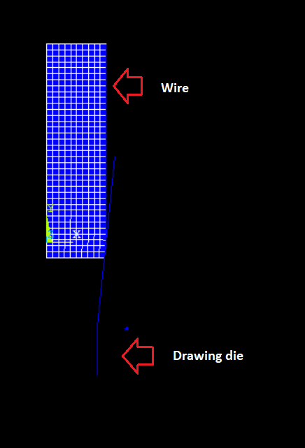

      Good afternoon,
      I briefly describe what I do. Initially I have a wire that goes through a drawing process which has been generated in a 2D-Axisymmetric model (Figure 1). The element type for the wire is PLANE82, with the axisymmetric property active. So when the wire goes through the drawing I get a wire with residual stresses and on that wire I need to perform a torsion test (Figure 2). In other words, I need to generate a 3D model of the wire from the 2D-Axisymmetric wire to be able to run the torsion test on this 3D wire. I've searched a lot but honestly I can't find any ideas on how to achieve it. Any suggestion is welcome, I will be very grateful. Thank you very much in advance.
    • Vigneswaran Sridharan
      Try performing a general axisymmetric analysis of the model. This analysis behaves like a 2D-axisymmetric analysis with additional DOF for bending and torsion.
      I recommend watching this AIC video to understand how to convert 2D to 3D models. Efficiently Analyzing Structures with a Constant 2D Profile Using Ansys Mechanical
      In MAPDL, use Plt Ctrls>>Style>>Symmetry Expansion>>2D-axisymmetry as an equivalent command to symmetry option in WorkBench.
      Other help links:
      Performing a 2D to 3D Analysis
      Thanks!

        I thank you very much for your answer. I have an additional question, in reference to this post, my goal now is to perform a nonlinear torsion test on this 2D-Axisymmetric result. So I would like to know if any of these possibilities exist in ANSYS APDL:
        1. Directly apply the torsion moment in the obtained 2D-Axisymmetric model, since in the manual where it describes the elements, it indicates that this element has the following:
        PLANE 182:
        KEYOPT(3)
        Element behavior:
        6 -- Axisymmetric with torsion (KEYOPT(1) = 0 only)
        So, can torsion be applied directly to this result in 2D-Axisymmetric?
        2. Convert this 2D-Axisymmetric model into a 3D model to apply the torsion moment, since I not only want to visualize the model in 3D, but to be able to apply the torque/torsion moment there to perform the non-linear torsion analysis.
        Or if you can recommend me another solution, I would be very grateful. I thank you in advance for your attention, I ask you to please help me clarify these doubts.
