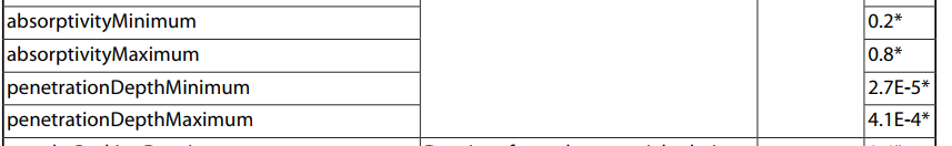

Ansys EmployeeThe absorptivity Min/Max are unitless fractions (or percentages). So "0.2" mean 20%.Â
The penetration depth units are meters.
This will be clarified in R2024-R2 release.
Thanks for the feedback.
February 14, 2024 at 8:18 pm
n n
Subscriberis these values of penetration depth available for all materialsÂ
