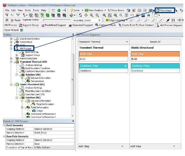

      I am trying to predict distortion and residual stresses in a part in ANSYS Mechanical 19.1 using the additive wizard. The simulation process perfectly converges until the step of base plate removal is reached. I know the build has to be constrained properly to get the deformation and stress state effect after the print is removed from the base, for which the three nodes I chose were 3 corners of the build which in my opinion should perfectly constrain the model in 3 translation and 3  rotational degrees of freedom, but the solution is always interrupted because of rigid body motion. Could I be given any tutorials on how to constrain the build after its removal from base.
      I have attached the model image along with this message.

      Ashish,
        Can you post some images on how you are constraining your model, the error message, and your structure tree?
      Sandeep

    • Sandeep Medikonda
      Ashish,
        I noticed that you are using APDL commands, In 19.1 you would have to set the following in Solver Process Settings:
      Can you confirm if you are doing this? Also, are you using the worksheet to remove the base removal?
      If none of these suggestions help can you try selecting a different node instead of the one at the very corner to constrain your model? Please select a different node which is not at the interface?
      Lastly, if nothing helps, can you post the last part of your solution output using the Preformatted text option in your reply?
      Sandeep

      Best,
      Ashish
    • Sandeep Medikonda
      Ashish,
        Can you include the following command snippets and set up a run?
      amstep,build,,,4        !This will use 4 Time steps when heating is applied
      amstep,build,,,,4 !This will use 4 Time Steps between layer additions
      amstep,cooldown,,,40 !This will use 40 substeps for the cooldown process
      If this doesn't work, check the 'ds.dat' file in the solver files directory and report back what additive commands are being used?
      Look for keywords that start with 'am***' such as ambuild, amstep etc.
      Sandeep
    • Sandeep Medikonda
      Also, try a case by constraining the face where the 3 selected nodes are on the side face, So like on the smaller cross-section face in your first post?
    • ashish35
      Sandeep,
      I got the problem resolved as I removed the contact region generated between the interface of part and support. Thank you for your help.
      However, now I am trying to get the distorted part with built in stresses (without the baseplate and support) and applying external load on it to get the superimposed stress values. Could you please suggest me how can I proceed for this task?

    • Sandeep Medikonda
      Did you have to kill the contact? I am curious as you would need contact between them during the AM steps right?
    • ashish35
      Sandeep,
      Yes, it seems contact region between base and build is sufficient to successfully complete the AM removal step.
      Actually I tried taking my part and assigning the support structure automatically from ANSYS (not defining the support through a CAD model), and I noticed that the automated wizard that ANSYS AM has does not create contact region between part and support (but it does between part and base interface).
      So, with this observation, I deleted the contact region between the support configuration that I had and the part. It surprisingly didn't give me any rigid body motions. I really have no clue how.
      Best,
      Ashish
    • Sandeep Medikonda
      Ashish,
        Try to use the direct solver when you see convergence problems in the base removal step.
         Introducing additional contacts is unnecessary when using the Wizard which overrides an internally created build-support contact.
        Just FYI: A colleague of mine has pointed out that all manually created (i.e. not the internally created build-support) contacts are killed on base removal step. This bug is rectified in R19.2.
      P.S: If you have found a solution to your initial query, please mark it as a solution (even if it is your own post) so that it would make things easier for someone going through it at a later time.
      Sandeep
    • ashish35
      Sandeep,
      My instincts were telling me that it was a bug. Thank you for your help.
