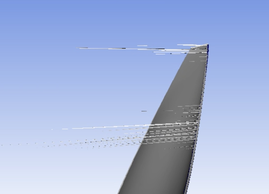

ansys ACP. Stitching occurs during the design of composite materials.
    • sux
      I am a student majoring in aerospace propeller design. When I used the surface model in ANSYS ACP to design the composite material structure, after the "Solid Models" step, protrusions would appear at the tip of the propeller. I want to know what I should do to solve this problem.
      Thank you.
    • Haifeng Niu
      You may consider the actions below to address the issue.
      • Clean and refine the tip geometry and mesh.
      • Use the "Cut Off Geometry" feature to trim unwanted protrusions.
      • Adjust extrusion direction and boundary curves for solid model generation.
      • Enable and review shape checking for solid models.
      • Export boundary surfaces for further CAD-based modifications if necessary.
      Also please refer to the guide/tips from Ansys documenation below.
      https://ansyshelp.ansys.com/public/account/secured?returnurl=/Views/Secured/corp/v251/en/acp_ug/acp_solid-model.html
      https://ansys13.ansys.com/KnowledgeArticles/Phase-2B/2055244/2055244.pdf#page=1
