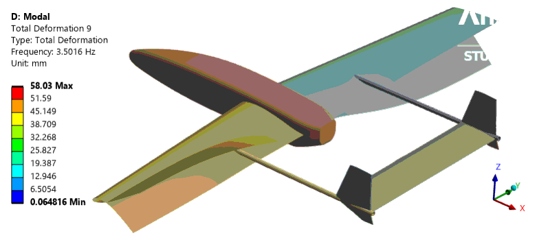

      Open the Geometry in SpaceClaim.  On the Workbench tab, click the Share button then the green check.  Now all the edges that touch surfaces will be connected to shared nodes in the meshing of the ACP/Pre block. I opened the Model cell and suppressed all the Contacts. I added a Modal analysis to the Model cell of Static Structural to show that all the parts are connected. What you can see is there is a need for a contact on the trailing edge of the wings.

      In ACP I've supressed all the connections, Now I can directly go to modal analysis to see if any connections aren't there right?? also in modal analysis any loads being given to see the frequency sir? Coz when i did, its showed zero frequency throughout and only tail fine was deforming away from the boom( Pic 2 reference), But In space claim the edge colour turned blue., so am bit confused here.

      Modal analysis is a useful diagnostic test for checking that the mesh is connected or bonded contacts are working. There are no loads in a modal analysis.  You can run it with no supports, but if you do, the first 6 modes have zero frequency if there are no unconnected parts.  The default number of modes to compute is 6 so that is not very useful, so I always request 12 or 20 modes.  It a part is unconnected, you will see it float around when you plot the deformed shape of all modes.  Notice that I plotted mode #9 to show the flapping of the wing rear edge.
      Your modal result shows that the tail fin was not connected to the other surface. I’m not sure why. What version of Ansys are you using?  I opened your model in 2025R1. You can Unshare the surfaces, then on the Repair tab, try extending the edge of the fin to the surface of the spar and redo the Share operation.  You can also use a larger tolerance on the Share operation.

      The Share button should make all the mesh connections you need if the geometry is properly trimmed. After doing a Share operation in SpaceClaim, open the model in Mechanical and under the connections folder, delete all the contacts. Solve the Modal analysis and check animations of modes 7 and higher to verify that all the edges that should be connected are behaving properly.

      Hello sir, Sorry to reply late.Share option solved the problem patially. Also in modal analysis i was able to see unconnected edges. I deleted those connections and created manual connection between edge and surface which solved the problem.
