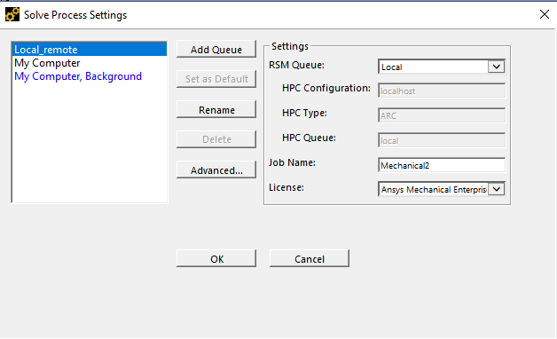

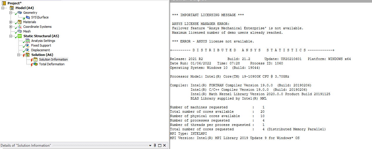

SubscriberHello, when I solve a job in Ansys 2021 R2 via the regular "my computer" default option, the student license loads and the job solves. However, when I send the job via RSM towards the local queue via Arc and a local staging directory, it doesn't recognize the default license and returns the error "Failover feature 'Ansys Mechanical Enterprise' is not available. Maximum licensed number of demo users already reached."

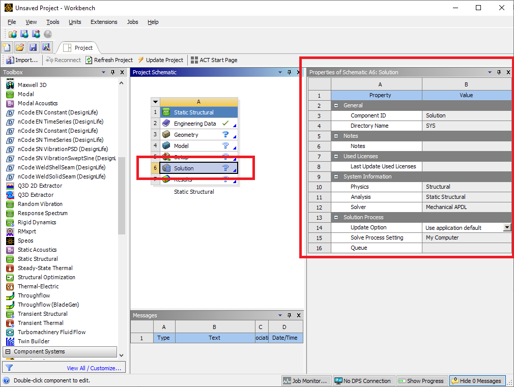

Forum ModeratorPlease try setting your Solve Process Settings and then exit Mechanical. Then run the analysis from the Workbench Project page. Trying to solve in RSM with Mechanical already open results in the error as the only Mechanical Enterprise license is consumed by the Mechanical GUI.

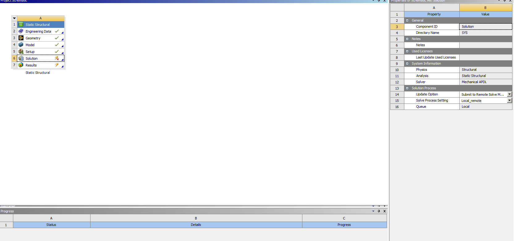

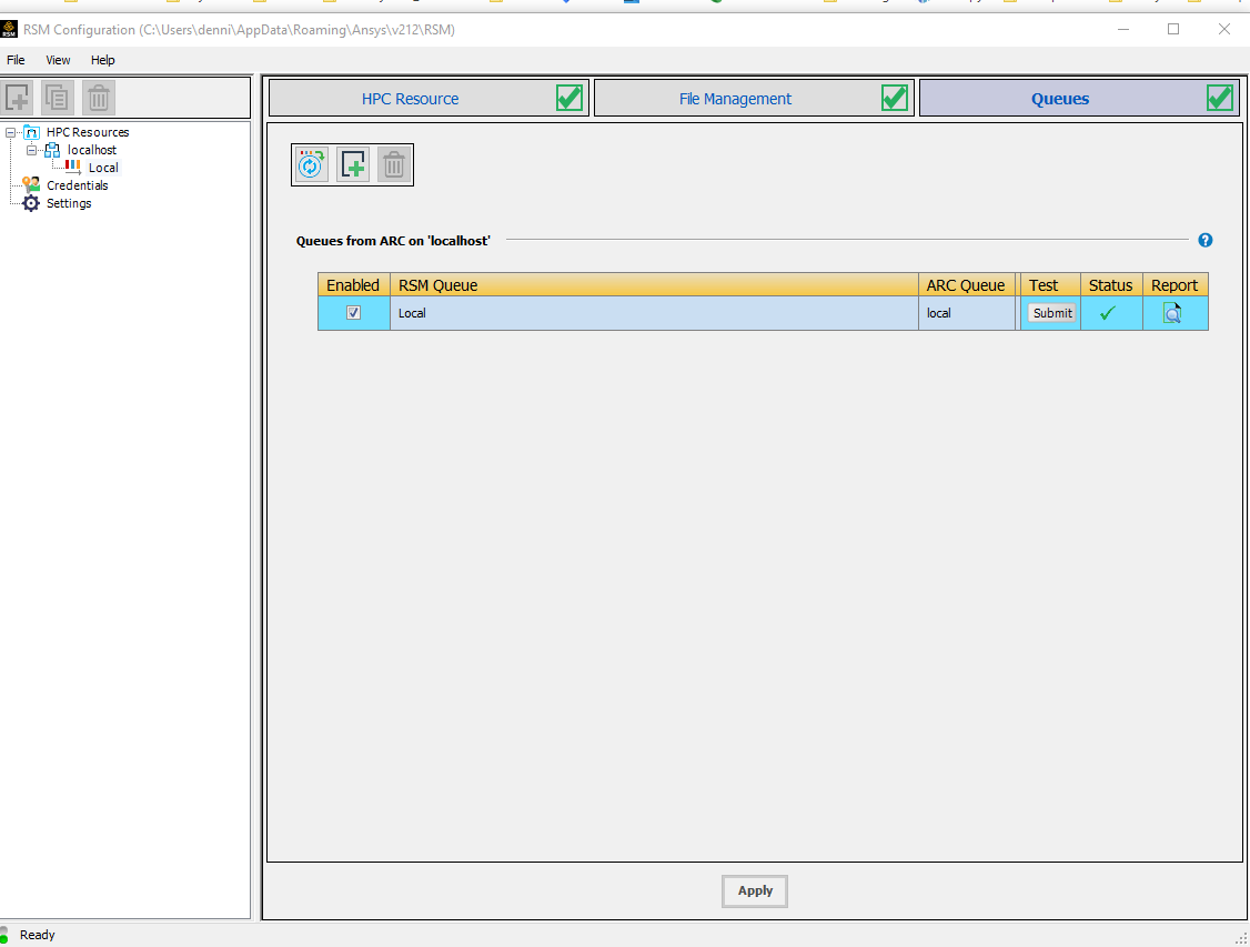

Subscriber@mmadore, Hello, I have already tried that as well. In the property setting, I went ahead and changed the default solving method to "RSM" and set the queue to the queue I created in the RSM configuration.
The same error occurs. Please note again that this does not happen in 2021 R1 but happens in 2021 R2.

Subscriberthank you for looking into this for me. Please see attached image and files you requested. The license debug file is converted to text file, hopefully that's ok. I also added any other possible screen shot that I can think of. Really appreciate if someone can at least re-produce this error on their end so I know it's not just my installations. If we can resolve this issue, it would be greatly appreciated.

Forum ModeratorPlease try using "My Computer, Background" and set it to use "Mechanical Enterprise" license. Exit Mechanical and any other Ansys windows fully, only the Workbench Project page should be open. Then try running by right-clicking on Solution and "Update".

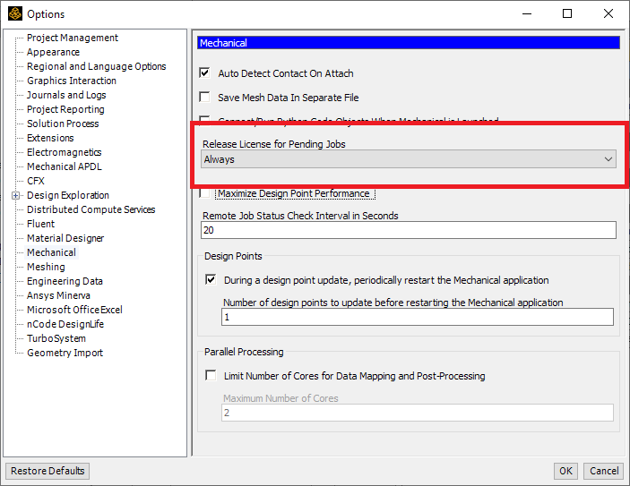

Please also go to Tools -> Options -> Mechanical from the Workbench project page. For "Release License for Pending Jobs" select 'Always'.
January 6, 2022 at 1:07 pmtofuu88
Subscriber@mmadore, changing the "release license for pending jobs" to always and solve in background worked! However, it doesn't work if I try to send the job via the Queue I created called "local" even if I solve it in workbench without opening mechanical. If I try to solve in background (after changing to "always) with mechanical open, it also doesn't pull the license.

The RSM local queue just queues jobs, which allows me to open a second instance of mechanical and do things while it's solving in background. Is this not allowed in 2021R2 but allowed in 2021R1?
