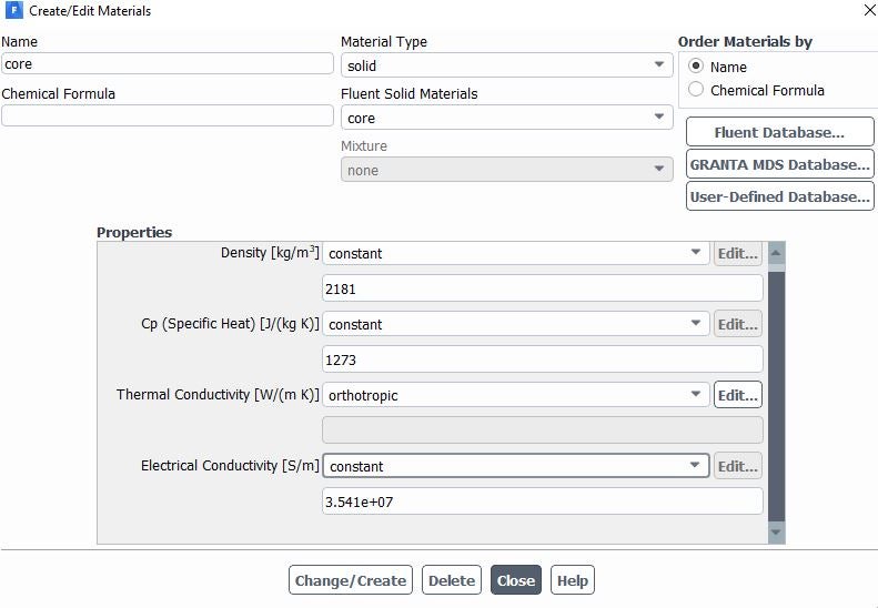

I'm using Ansys 2021 R1 Academic Version.
I'm doing battery thermal management analysis for my final year project in Ansys fluent using the
MSMD module.
I can't find UDS diffusivity in Create/Edit Materials under properties.
July 12, 2021 at 2:05 pmRK
Ansys EmployeeHello,
Under Electrical Conductivity, choose defined per UDS and UDS diffusion coeffecient dialogue box opens up. Please refer to this tutorial : https://ansyshelp.ansys.com/account/secured?returnurl=/Views/Secured/corp/v212/en/flu_tg/flu_bat_tutorial_cell.html?q=msmd%20diffusivity
July 31, 2023 at 7:13 amFatih Koçuşağı
SubscriberNamely, you have to create 2 materials. The first of these should be the active material. The electrical conductivity of the active material should be 'defined per-uds'. uds0=1.19e6 should be uds1=9.83e5.
The second material should be tab_material. Electrical conductivity=constant=1e7.I hope these infos will easier your job.Â
