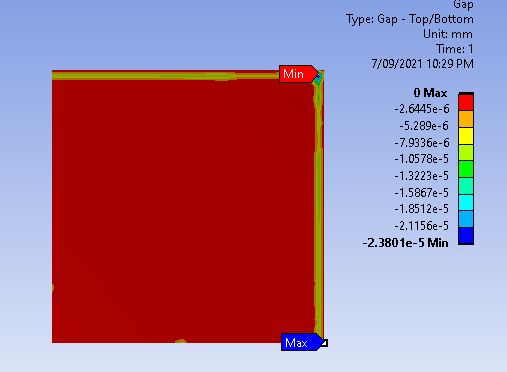

September 7, 2021 at 10:21 amShuo1
SubscriberHi Peter. Thank you for your suggestions. My simulation results are getting better. But after the simulation, there are red lightning on the solutions which means the simulation is not successful. I have attached some of the simulation results below including the contact tool of status, pressure, and gap. But I don't know what does the result of contact tools mean. Could you please tell me what's happening?
Another issue is that the thin film still penetrates the holder sometimes even if I have already set the holder as rigid. The images below show the penetration of thin films with 0.001MPa (first image) and 0.0005MPa (last three images) pressure. It doesn't make sense that a smaller pressure results in more penetration. I'm so confused.
Any help is appreciated. Many thanks in advance!
Kind regards Shuo
September 7, 2021 at 11:15 ampeteroznewman
SubscriberOn the Frictional Contact detail is an item called Pinball Radius, which is a radius from the contact surface to search for a target surface. When it finds that, contact elements are created to use in the solution. It is set to Program Controlled by default. What may be happening is that the default Pinball Radius is too small and there are no contact elements at the center of the hollow. The evidence for this is that there is no Gap showing at the center of the hollow. The corrective action is to manually type in a larger number, such as 5 mm.
September 7, 2021 at 2:31 pmShuo1
SubscriberThanks for the suggestion. I've changed the Pinball Radius and increased the pressure given to the thin film. Regarding the simulation result of the gap in contact tool as shown in Figure 1, it shows no gap between the thin film and the holder, which means the thin film has been attached to the holder. Am I understanding right? If so, regarding the simulation result of the directional deformation as shown in Figure 2, there are still some penetration apparently, but the stress distribution looks fine after I hide the holder. I'm wondering if it is okay? In another word, can I say it is a successful simulation? Any suggestion is helpful and appreciated. Thanks a lot! Kind regards, Shuo
Figure 1
Figure 2
September 7, 2021 at 6:45 pmpeteroznewman
SubscriberYes, this is a successful simulation.
Change the Stress Legend from Reverse Rainbow back to the Rainbow so the high stress is red and the low stress is blue.
