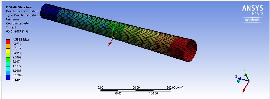

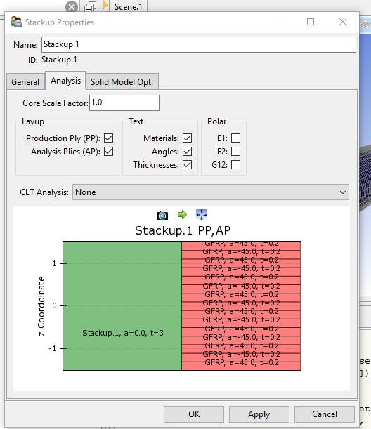

      I have modelled a composite shaft with 15 layers of glass fiber and applied a torque of 400Nm  on one end with fixity at the other end. I have done the same modelling in APDL  and I have obtained an angular deformation of about 0.1202rad. But in workbench(ACP) I am not getting the result correctly? Also I would like to know how to extract angular deformation in workbench?
      Result image
      Stack up
      Use a Flexible Rotation Probe on the edge.
