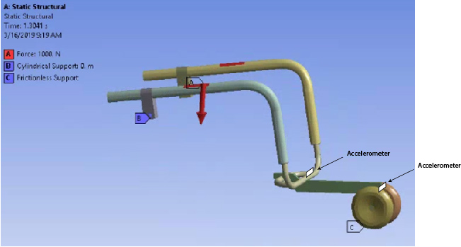

      I could take some data with either the accelerometers in my iPhone or one of the accelerometers in the lab, so that would be an option. If I do that, where would I want to put the accelerometers? Presumably near the wheel axle?

      To gather experimental data, mount the accelerometer on a rigid part of the frame near the wheel.

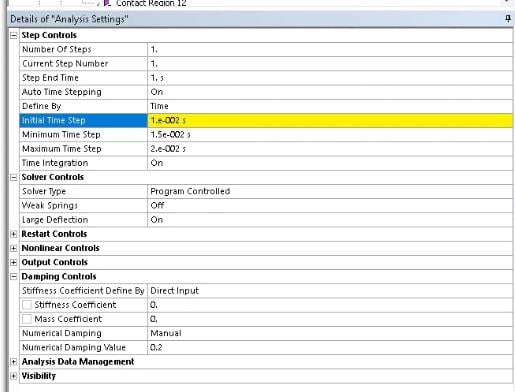

      What is the best way to calculate the minimum and maximum time steps in the analysis settings for a transient analysis for which I'm using the accelerometer data as an input? I know from theory that the step size should be about 1/20th of the natural frequency of the structure, but I haven't done a modal analysis on my model. Do you recommend this as a necessary pre-step to the transient analysis, or is an easier way to figure out what the time step is?
      I've tried guessing a few time steps. The error I get is "Invalid Time Step settings"
      Modal analysis solves quickly, so should always be done prior to running a transient structural model.
      Under Analysis Settings, set Auto Time Stepping to On, then provide an initial time step, which can be small, along with a smaller minimum time step and a larger maximum time step. The solver will automatically adjust the time step to get about 20 steps per the frequencies it detects in the solution as it solves.
      Please reply with a screen snapshot of the Analysis Settings, including the Damping Controls. You want to include some damping, at least 2% damping ratio, and possibly higher, like 5%. Without Damping, you will get high frequencies that you don't want in the results and larger responses than are realistic.

      However, I have attached a screenshot of my current Analysis settings below:
      Thank you again!!
      The minimum time step has to be smaller than or equal to the initial time step.

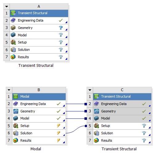

      3. Attach a Transient Structural to the Solution of the Modal analysis. This creates a Modal Superposition Transient, which is a linear version of the two full transient models mentioned above. The advantage of a linear model is it solves very fast. It is setup much like #2 above, but you have the option of applying the acceleration load to the supports "Base Acceleration" instead of applying the acceleration load to the mass in the model. You get a very similar stress result over time whether you apply the acceleration to the Base supports or you apply the acceleration as an Inertial load to the mass and let the supports be stationary.  Start with option #3 because it is the quickest model to get results from.  You can duplicate this Transient and leave out the Modal and then solve a Full Transient, just be prepared to wait a long time for results and have a large amount of free disk space, like 1 TB or more.

      Thanks again for all your help!! I took approach 3. I think that makes sense to me. At the moment, I’m trying to get a modal superposition transient analysis running on a portion of the model with very simple loading and boundary conditions. I’m still getting some errors on the time integration and solver control steps during the modal analysis.
      I’ve tried iterative and programmed controlled solver types, as I managed to get the transient analysis part to run with the iterative solver type.
      I’ve attached some screenshots of the error I'm currently getting. Would you be able to help me out with these settings?
      Thanks!
      Please insert a sketch that shows where on the frame the accelerometer was mounted. You said that was near the axle. So the parts of the frame above that point would be in the model to show the response to what was measured at the bottom of the frame near the axle.  The axle would be the Fixed Support in the Modal analysis.
      If you link the Solution of the Modal into the Setup of the Transient Structural, then you don't need a Fixed Support in the Transient Structural. The shapes from the Modal analysis already incorporate the Fixed Support, so you don't repeat that in the Transient Structural.
      The results from the Modal are only the 6 displacements for the 6 modes you requested. Don't plot stress in Modal, that is meaningless.
      The load in the Transient Structural is an Acceleration inertial load and you copy/paste the measured accelerometer data (in the correct units, m/s^2) into that Acceleration tabular data.  You can plot stress in the Transient Solution.

      I've attached two locations that I'm using to take accelerometer data from (for separate studies). So with the more forward position, I will make the axle as a fixed support as you suggested. I'm considering the location on the frame and removing the front attachment from the FEA model. Do you have an opinion on which would be better?
      Thank you!
      I see the cylindrical support B, and I think there must be a much larger frame that this small frame is connected to at this cylindrical support. If you put the second accelerometer near that "axle" at B and the first accelerometer as you have near C, then you could have each of those be acceleration inputs at each axle and the frame between them would respond dynamically.
      Are the accelerometers XYZ or just single axis?  It would overconstrain the model if you applied XYZ accelerations to two points on the same frame.  If we say X is along the direction of travel and Y is up, then you could have XYZ inputs at point B and just the Y input at point C.
      Also, does the Force at A actually represent a 102 kg mass acted on by Gravity? If so, it is better to add the mass to the model and turn on Gravity. Then the accelerations input at B and C act on the mass and cause stress in the frame at a level higher than the static force of 1000 N.
