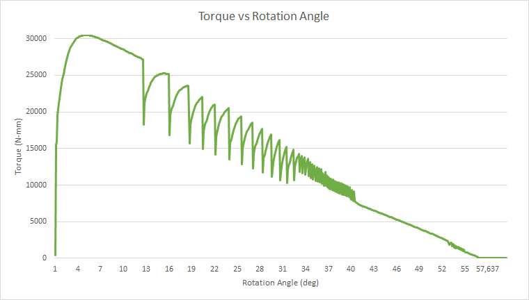

 Also, I have done a simulation for a normal untightening scenario. I have applied a rotation and extracting the torque from the result.
  My question here is about the waves that are visible. My question here is about the waves that are visible.
 Is it because of the solver that it is visible or has it got anything to do with the physical phenomenon? What is significance of those increase and drop in the torque value? Why is it observed and how can it be eliminated?
