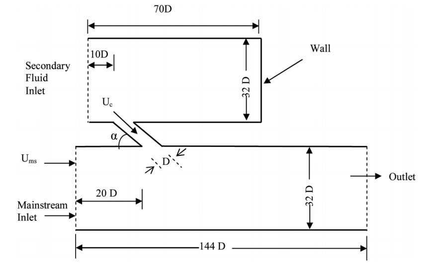

SubscriberHello all I am working on post-graduate project on film cooling on flat plate (without rotation). I tried with various pressure-velocity coupling schemes, but even after 1.5 day my result is not attaining steady state, and the contours of temperature is not changing after certain iterations even after 3-4 hours of solving them.
Mesh:
Flow will be turbulent and hence for y+ = 1, first cell spacing from wall has been made, and aspect ratio (max) is around 500, total mesh cell count around 1.3 million. Image of geometry is attached below [Paper]: (here D = 6.35 mm)

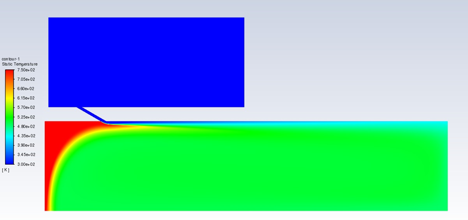

3. For COUPLED with and without Pseudo-Transient, I am not getting steady state convergence. For both my continuity residuals attains 1e-3 and after that convergence doesn't occur. For your reference, I am attaching an image without Pseudo-Transient after 55000 iterations. Also even after so long time, I find the same contour.

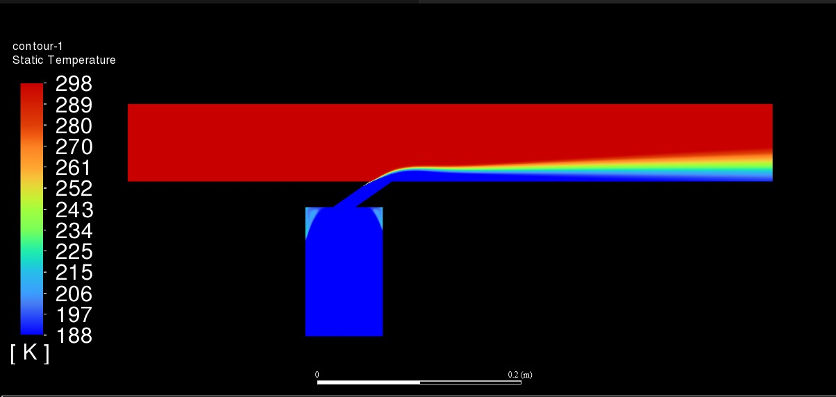

For your reference, I am attaching similar kind of simulation I did with other geometry:
Journal Paper
The paper linked uses temperature piecewise polynomial for Cp, K, Dynamic Viscosity and density is considered as ideal gas. Since both fluid coming at different density and velocity this is one of the way to replicate the phenomenon. Else we can directly use species transport if density and other parameters are not relatable to each other.
