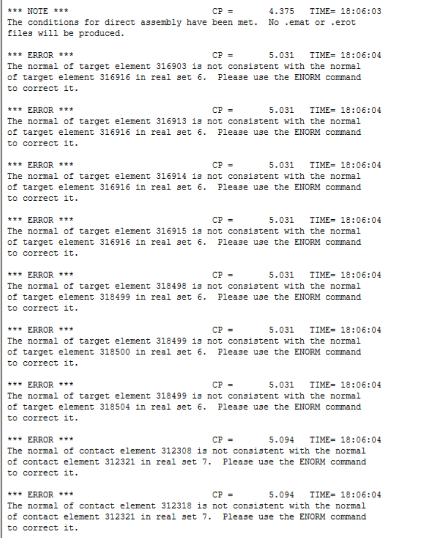

    • sunho
      Hello
      During Trying A.C.P. i got error and warnings " An unkown error occured during solution". "one or more objects may have lost some scoping attachments during the geometry update."
      I check the solver output on the solution, but i don`t know how to check error. (How to check elemet **** and What is mean " ENORM)
    • Kakadiautsav
      Hello, I have solution, It may be because the computer can-not handle all the load at once.
      So, I suggest to convert mesh elements from quadratic to linear.. {it helped me with same problem}
      There is a drawback of it, you will loose little accuracy on your result...
      I hope this help..

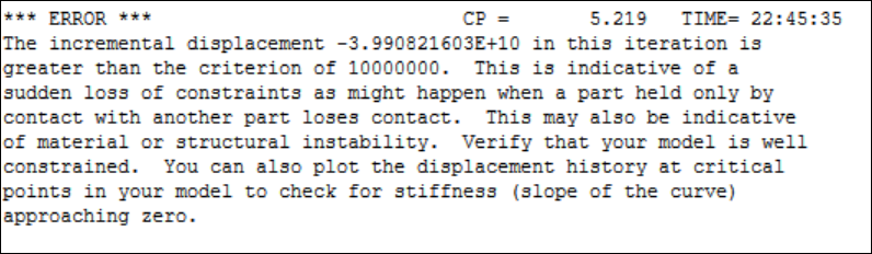

    • Abhilash_Sharan
      I got error in Transient Structural ANSYS Simulation as " An unknown error occurred during solution. Check the Solver Output on the Solution Information object for possible causes".
      Help me in getting the solution please.

    • Claudio Pedrazzi
      the image you are showing is not the solver output.   Under "output" select "Solver output" to see it (where now it says "Force Convergence".
