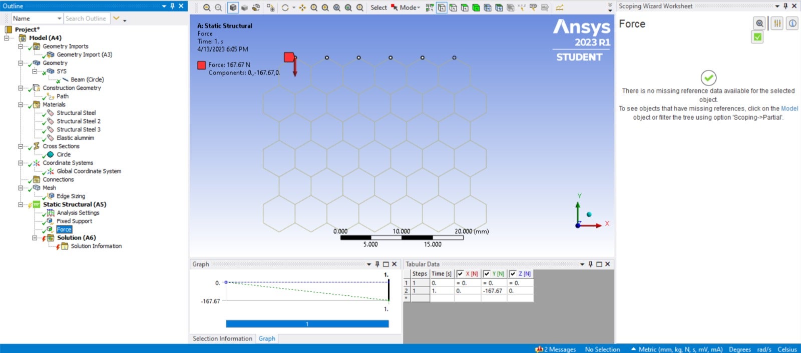

      • Shady Sawires
        please, could you help me with my question? it is urgent.
    • Shady Sawires
      Hi, I need an urgent reply to this question. this is the solution information output message when I try to solve the model.
      Ansys Mechanical Enterprise Academic Student

                **  MAPDL COMMAND LINE ARGUMENTS  **
        BATCH MODE REQUESTED (-b)    = NOLIST
        INPUT FILE COPY MODE (-c)    = COPY
        DISTRIBUTED MEMORY PARALLEL REQUESTED
             4 PARALLEL PROCESSES REQUESTED WITH SINGLE THREAD PER PROCESS
          TOTAL OF     4 CORES REQUESTED
        INPUT FILE NAME              = D:\Family\_ProjectScratch\Scr2789\dummy.dat
        OUTPUT FILE NAME             = D:\Family\_ProjectScratch\Scr2789\solve.out
        START-UP FILE MODE           = NOREAD
        STOP FILE MODE               = NOREAD
       RELEASE= 2023 R1              BUILD= 23.1      UP20221128   VERSION=WINDOWS x64
       CURRENT JOBNAME=file0  17:53:42  APR 13, 2023 CP=      0.078
