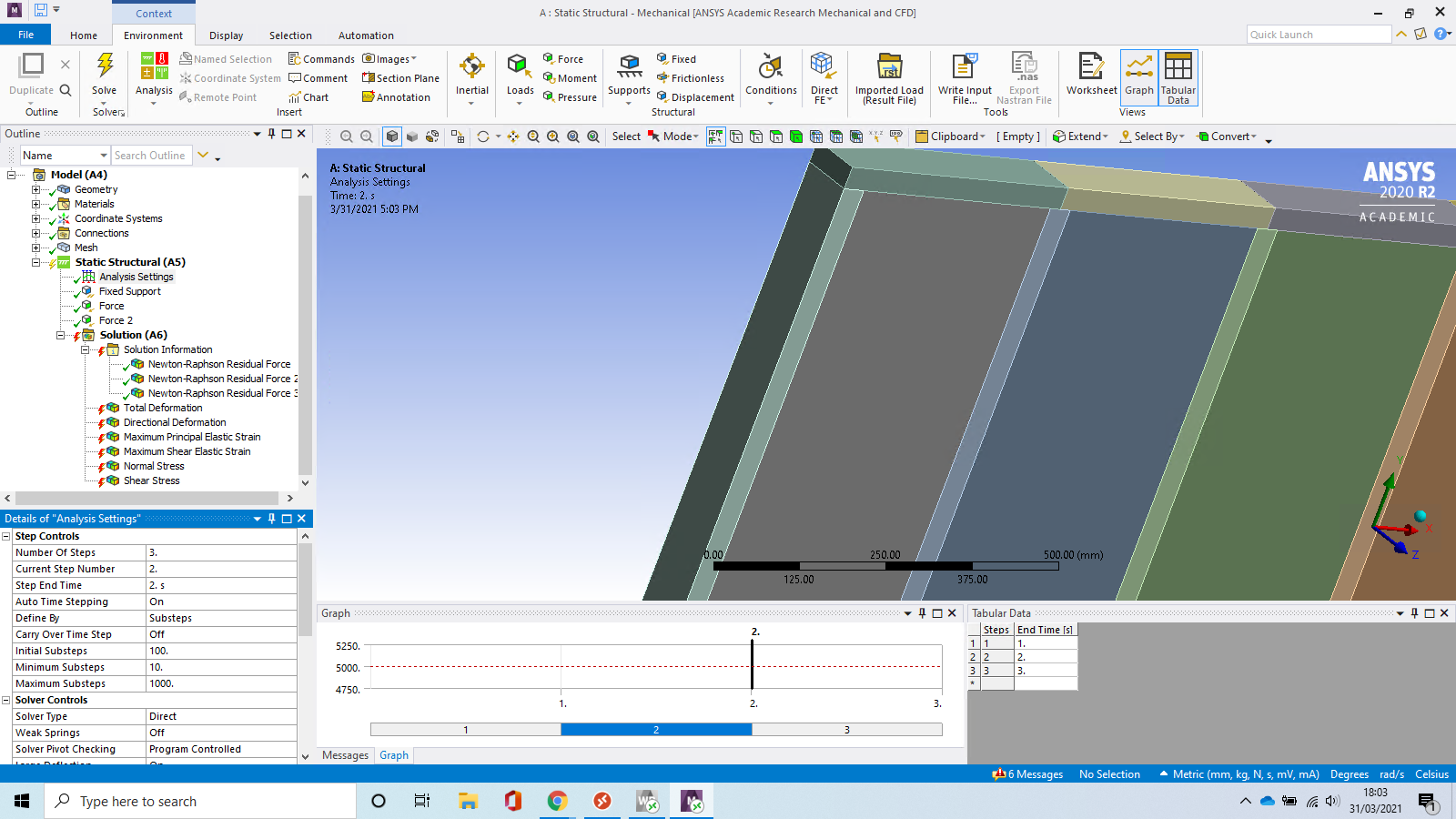

      nUnder Analysis Settings, turn on Auto Time Stepping.nChange the initial substeps to 100, minimum substeps to 10 and maximum substeps to 1000.nUnder Solution Information, type 3 for Newton Raphson Residuals.nThen Solve.n

      nPlease reply with an image of the Analysis Settings for Step 1. nWhat number did you use for Initial Substeps? The graph is informing you to use a number 8 times larger.nPlease reply with an image of the Anaysis Settings for Step 2.nThat should have an Initial Substeps value similar to Step 1.nn

      Sorry about the delay I've been having issues with my remote desktop and accessing Ansys on it. I have managed to down load it onto my pc there and I only changed the subset setting for step one, I didnt realised I ad to do them all seperatly. Hopefully I be able to run the program soon on the remote desktop and will let you know if it is successfulnn

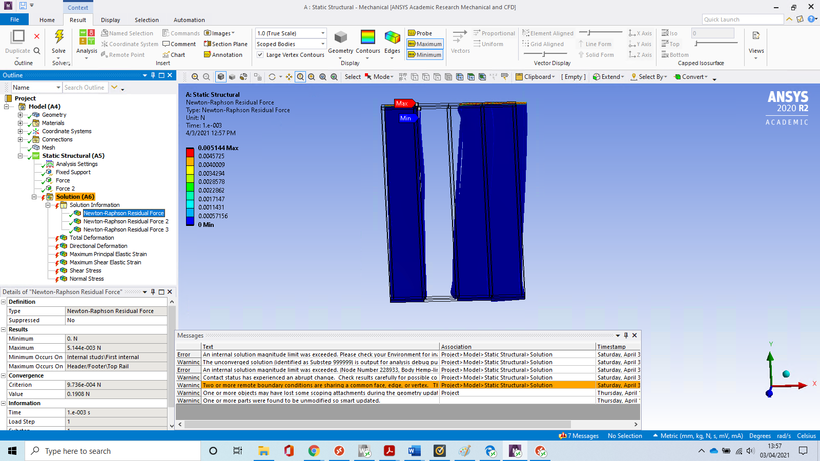

      nThere were 3 converged substeps, you should look at those. Reply with an image of the last converged substep for Total Deformation. Is it behaving the way you expect?nThere are 3 Newton Raphson Residual Force plots, you should look at those, they are under the Solution Information folder. Look at the location of the maximum. Do all three plots show the same location? Reply with an image of the elements around the N-R-R maximum. This generally indicates where you need to make a change. The change could be to soften the contact, or it could be to use smaller elements. Show us the plot.n

      nCorrect, you got 3 converged substeps in step1.nWere you going to show me the plots of N-R Residual and the last converged substep?n

      Sorry been running a solution for over 24 hours now. Realised the top and bottom rails were off by .2mm and fixed that woudl that have been an issuue? The program is currently on step 810 furthest point it has gotten to in a while. I have gotten a warning saying Two or more remote boundray conditions are sharing a common face, edge, or vertex. This behaviour can cause soler to over constraint and is not recommended, please check results carefully. you may select offending object and/or geomerty via RMB on this warning in the messages window. would this have anything to do with how long it is taking to solve?n

      The solution failed at 1336 the deformation has a large hole in the second infill, not sure why it just happened for this one, As the others seem to be un effected. nn
      nDon't look at the Unconverged step. Look at the last converged substep.nUnder Solution Information, show the Time Increment Plot.nUnder Analysis Settings, show the Step Controls. What is the Minimum and Maximum Substeps?.
    • Smileyniall
      The max and min subsets are the same for all stepsnn
