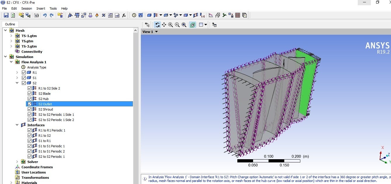

Ansys EmployeeHello,
You can visualize this region in CFD-Post. You can create iso-volume. Create a sphere around this point and adjust the radius of the sphere for better visual aid Then you can fix the mesh near that region.
Regards SD
