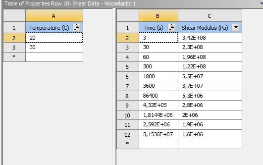

      What do you mean to curve fit separately? I input the relaxation data at 'Shear Data - Viscoelastic' for 20 and 30°C [Fig]. When I do curve fitting, Prony coefficients are generated for both temperatures automatically. How do you do them separately? And these coefficients will be the same even if I solve the curve fit for 20 and 30°C separately in separate Engineering Data standalone systems.
      1
    • John Doyle

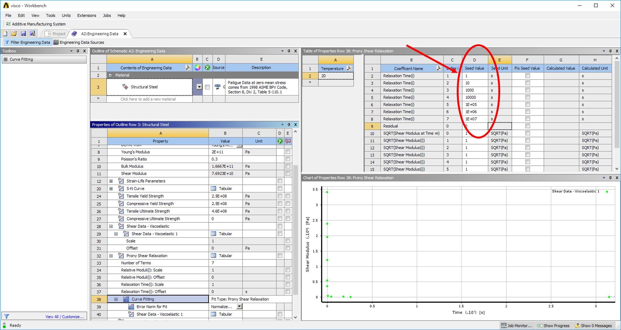

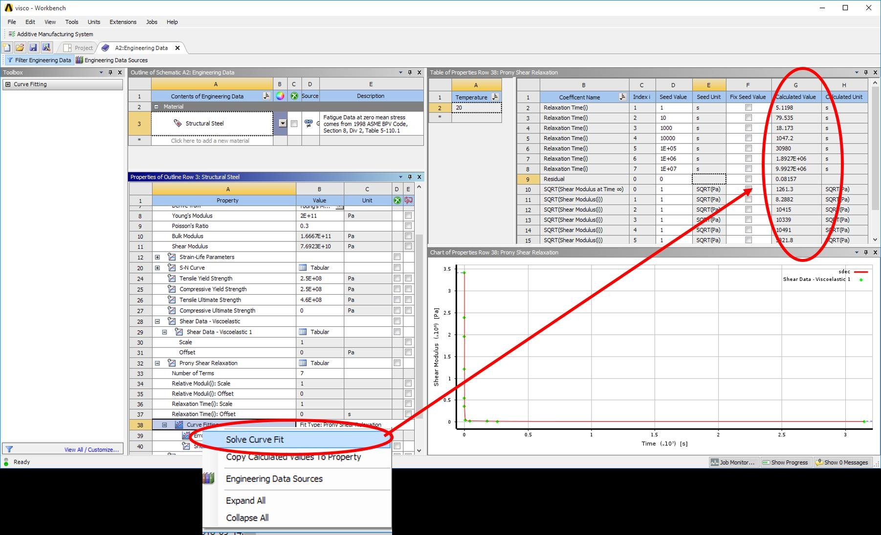

      If you are not using a shift function and you read in multiple sets of relaxation data for different temperatures, you should get a different set of prony coefficients for each temperature.    If you include a shift function as part of the curve fitting, you need to specify what the master curve is.
      I suggested just trying to curve fit one temperature because that is often easier to trouble shoot when the curve fitting is not working out.
      The images below show a successful curve fit with 20C using the data you provided.  I used 7 terms and seeded the relaxation times to go from 1 sec to 1e7 because that sometimes helps produce a better fit.  It doesn't matter if the relaxation times for each term are not in ascending order.  Just think of it as seven terms in a mathematical prony expression to represent the relaxation of the modulus over time.  Also, I think there might be more then one solution to this problem.  In other words, using different numbers of terms and using default seed values might produce another combination of prony terms that is equally valid for matching the relaxation behavior.
      I hope this helps.
    • jonsys
      jjdoyle,
      thank you for the reply. I researched a bit more about how this works and now I understand that terms do not matter to be in order.
      The tip for seeding relaxation time from 1s to 1e7 helps because the fit is better now; thank you. However, if we use a logarithmic scale for axes of the graph we can still see that the fit might need improvement.

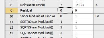

    • Bhargava Sista
      Jonsys,
      Curve-fitting is usually a nonlinear regression optimization problem which requires an "initial guess" (or the seed value) for the parameters that are being calculated. Highly nonlinear systems such as this one tend to have multiple local minima and the choice of initial guess can influence the local minima that the optimization algorithm will find. So, it is necessary to use physically realistic seed values for relaxation times. Just getting the order of magnitude in the ballpark can do the trick. One way of physically interpreting the Prony series is: the stress relaxation happens over a time and there may be multiple relaxation chains (mathematically, Prony terms) that may be contributing to this relaxation. So, a Prony term (Gi, Ti) may be interpreted as Gi fraction of the total stress relaxases over a time of Ti. This is a very loose interpretation of the math but it'll help in understanding the Prony series better.
      For curve fitting, look at the timeline of your data. E.g., if you have data for a time of, say, 10^6 sec, and if you're using 3 Prony terms, then use seed values for time constants evenly distributed along that timeline (1s, 1e3s, 1e6s) or if you see a sharp dip at around 1e4 s then (1s, 1e4, 1e6) would be a good start. This way you'll have better chances of capturing the relaxation terms that are prominent along the timeline.
      In general, you need not assign seed values for shear modulus and residual so don't tinker with them for now.

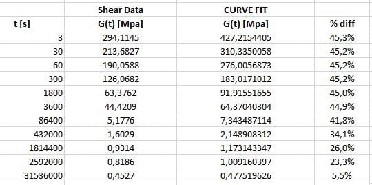

      • Based on the relative moduli and relaxation time, I am calculating time dependent Shear Modulus just to compare input and output comming from the curve fit. From [Fig 1] it can be seen that the difference is still high, even though for the curve fit I used physically realistic seeded values as suggested.
      • And alpha infinite (long term relative moduli) comes from G infinite/G0 [Fig 2]. What value is by default chosen by ANSYS because I do not input into the software a value for long-term modulus.

    • Bhargava Sista
      Ah, don't do that!
      While performing the Prony series curve fitting, the material stiffness is not considered since we deal with normalized numbers. I don't know exactly how ANSYS does this but when I wrote my own script for curve fitting, I normalized the relaxation stress curve by dividing the stress values by the peak stress (stress at t~0s). ANSYS might be doing something similar, did you try that?
      We generally need two sets of data for fully calibrating viscoelastic materials
      • uniaxial tension/compression (and other modes of deformation) for calibrating the elastic properties
      • stress relaxation data for calibrating Prony series properties.
      Both the properties are calculated separately via curve fitting.
