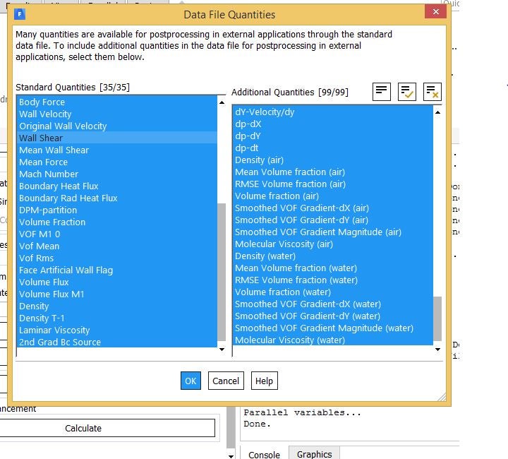

SubscriberDear sir, currently I am working on VOF-gravity -Transient-two phase model in ANSYS 2021 R1 fluent...I am facing a problem of exporting few data file quantities in POST PROCESSING .....All data file quantities are not appearing...I have attached both screenshots i.e 1) First screen shot is Data file quantities selected in the solution tab
2)Second screen shot is Data file quantities showing in POST PROCESSING .
Please suggest how to get all data file quantities/variables in CFD POST PROCESSING in ANSYS 2021R1, Even i have tried in the variable list of POST PROCESSING to draw a chart but all are not appearing.

Ansys EmployeeYou can use .cdat file. You can use File -- export - solution data - during solution.
You can also search this forum for the same. There are few posts on it.
Regards Keyur
June 4, 2021 at 2:11 amKeyur Kanade
Ansys EmployeeAlso make sure that you select only quantities you want while exporting in cdat.

SubscriberBut in other versions (2017, 2018..etc) It has come default, while selected in the solution module...But 2021 R1 It is not showing in CFD POST......It is typical to export the .Cdat file for different time seconds...My solution time is approximately 1 sec, for every 0.02 sec I have take the readings....so I am facing a problem...Please suggest in 2021 R1....Your suggestion in this regard highly appreciated...

Ansys EmployeeUsually we use cdat file. While exporting cdat file, we use only variables we want to post process. This way file size is also small.

SubscriberData File Quantities will only make it into CFD-Post if you save in the legacy format. So .dat instead of .dat.h5. You can change the default in File > Preferences > General
