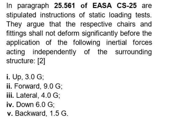

      This is explanation for static

      By the way what about static conditions. I guess using static structural with constant force inputs will be enough, am I right?
      The static load is simple to apply. It is not a force, it is an acceleration and is found under the Inertial category.
    • Oguzhansevim
      Sir, can you please give me more information. What do you mean by Inertial category?
      For example; Forward 9g case
      (total mass of design)* (9,81) * (9) = 24kN   how to apply this effect
      You mean inserting 24kN force in static structural won't be correct, right?
      In preparation, all your materials in Engineering Data must have the correct Density assigned as a Physical Property.
      The Inertial category button is next to the Loads button.
      Click on Acceleration and then type in the value in the correct units. 1 G = 9.8806 m/s^2.
      In this example, the units are in meters so type type the multiplication right into the field.
      If the seat is facing in the +X direction, a negative value in the X Component will be the "forward" acceleration value.  A positive value in the X component will be a "backward" acceleration. If your Y component is up, then a positive value will be "downward" acceleration while a negative value will be a "upward" acceleration.  The Z component will be the lateral acceleration.
