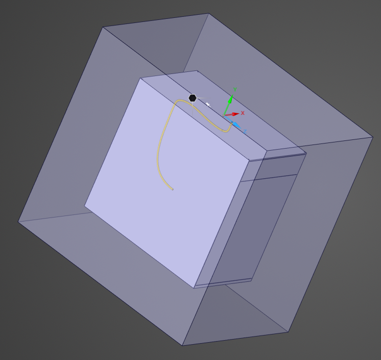

      hi -
      I am trying to model air flow starting inside a computer case and exiting through various means.  I created an enclosure around the case and did a volume extract using the walls of the enclosure.  That seemed to work, but I am not sure if that was correct. I am also not sure if I am supposed to define the walls of the enclosure as 'symmetry'.  My largest hurdle is creating an air input.  Currently, I have a line that enters the top and exits in the middle of the case.  i can do a volume extract on that line and define the Airin and Airout, but when I do a volume mesh they get lost since the air line is inside the enclosure.  Is there a way to define a point source for an air exit?
      Do you need the "outside" or would domain boundaries on the casing be more suitable? Are you using a forced flow ie fan at one end of the server rack with a few holes or a box with holes and a load of fans like a more common desktop? Are you using Fluent?
    • SRP
      A line has no area, so the mesher will ignore it in a 3D volume mesh. You need a surface for a boundary condition. That’s why your “Airin/Airout” get lost.
    • andrew.m.hayes
      I am using an air input inside the computer case, so I 'think' I need the domain outside the computer (the enclosure) case to model the air flow out of the case
      When I do a volume extract of the air line I do have two surfaces that I have defined as "in" and "out", but when I do the volume mesh the fluid zones get merged, since both the in and out are inside the enclosure
      OK, so air is flowing around the outside of the case. Normally we'd ignore this but if there's a risk of pulling warm air back in it may be useful. I'm not sure what the line is? I'd expect holes/fans etc to draw air back into the box and would set these as "fan" or "interior" or "porous-jump" labels at the geometry stage. That should also avoid Fluent Meshing losing surfaces and cell zones.
