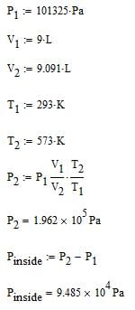

I would like to analyze situation when air is closed in box for example 300x300x100mm (thicknes = 10mm), this box is made by welding on full penetration six pieces of plate, next it will stay for a month in temperature 20C so we can assume that temperatur steel box and air will be the same, during welding we will have a smal hole (radius = 5mm) in one plate, closed by welding when temperature of steel box and air reaches the value 20C. I'm aware of welding stresses, but I would like to omit them and consider only influance pressure from expansion air after heating, considerated in the same time expansion of steel box (non-linear material).

The volume enclosed in the box is 9 liters (assuming the thickness is on the outside).
To make this simple, assume the box doesn't change shape when the temperature increases. When we do the analysis, we can measure a small volume change due to the sides of the box bowing out very slightly due to the pressure, but with a 10 mm thick wall, that is going to be practically zero. At 1 mm it may have been measurable. However, we can easily estimate the volume increase in the box due to thermal expansion.
The coefficient of expansion of steel is 1.2e-5/C and the temperature change is 280 C so the box grows to 9.091 L because 30 cm grows by 1.2e-5*280*30 = 0.1008 cm and 1/3 of that for the 10 cm dimension.
Temperature in the Ideal Gas Law must be in Kelvin, so the two temperatures are 293 K and 573 K.
Atmospheric pressure is 101325 Pa, which is what we assume was the pressure when the box was sealed.
The Ideal Gas Law is used to calculate the pressure of the air when the temperature increases from 293 K to 573 K while the volume increases from 9 L to 9.091 L.
ANSYS Static Structural is interested in the pressure difference between the inside and the outside of the box, so subtract off the atmospheric pressure.
If you apply a pressure to the inside of your box of 94845 Pa, that will generate the stress caused by raising the temperature of a sealed steel box containing air (or any gas) of the dimensions given from 20 to 300 C.
