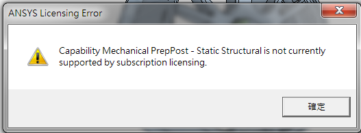

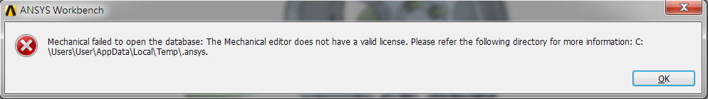

Ansys EmployeeHello Kin
The connectivity option between AIM and Workbench is not available with a subscription license, as the Workbench does not currently support a mixed licensing model (subscription for Discovery and floating for Workbench). I would request you to post your suggestion in the Ideas section so that other users can view and vote for it.
I am cross-checking with the development team and will let you know.
December 14, 2018 at 4:09 am
Naresh Patre
This workflow is only possible if you have a Mechanical Enterprise license (which also enables Discovery AIM), or a lower level Mechanical license and an AIM Pro License.

Naresh Patre
Ansys EmployeeHello KinÂ
A Mechanical Pro license plus an AIM Pro license will support this connectivity; and a Mechanical Pro license plus a Discovery Ultimate Enterprise will support this connectivity. Â As long as both the Mechanical and the AIM licenses are floating licenses the connection will be available.

Naresh Patre
Ansys EmployeeKin Its currently not possible to use a mix of subscription and floating licenses. You may want to post your suggestion in the Ideas section.
