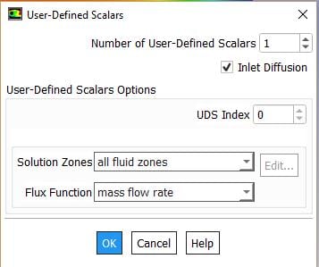

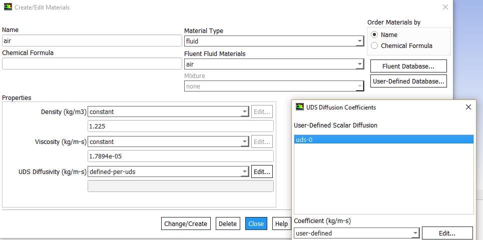

      Hello everyone,

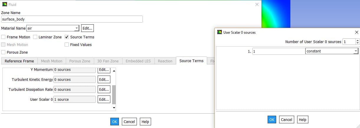

      I want to calculate Age of Air in Ansys Fluent. I found this in UDF Manuel,
      "The following UDF, named mean_age_diff, computes the diffusivity for the mean age of air using a user-defined scalar. Note that the mean age of air calculations do not require that energy, radiation, or species transport calculations have been performed. You will need to set uds-0 = $0.0$ at all inlets and outlets in your model. This function can be executed as an interpreted or compiled UDF.
      UDF that computes diffusivity for mean age using a user-defined
      scalar.
      #include "udf.h"
      DEFINE_DIFFUSIVITY(mean_age_diff,c,t,i)
      return C_R(c,t) * 2.88e-05 + C_MU_EFF(c,t) / 0.7;
      I also changed some settings and you can see them below.
      I am not sure about the value which I wrote "1" in below
      Is it enough?
    • DrAmine
      You need to provide the density of the material instead of one.

      Look at what you're setting: diffusivity. Then consider that viscosity, density etc play a part in that. What are the material properties of a scalar? n
