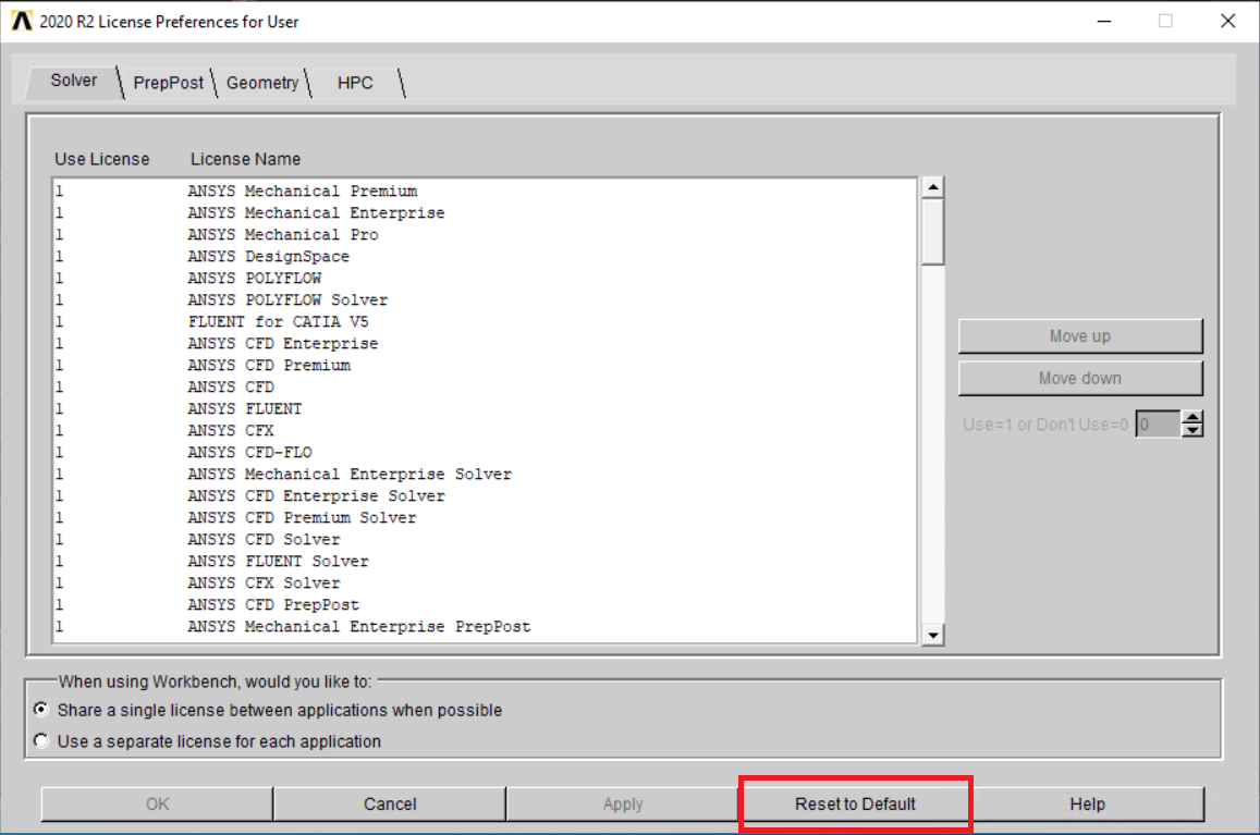

Ansys EmployeeIf the License Manager and license file is updated to the Latest version (2021 R1), the a reset of the license preferences must be done. If not, earlier versions will receive license errors.
Go to the User License Preferences for your version and choose: "Reset to Default"
This should fix the issue.
