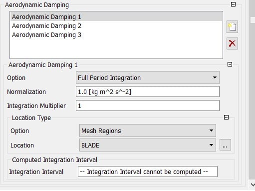

I want to know how to set the normalized value in CFX to calculate the aerodynamic damping. As shown in the picture attached below, the value set in Normalization is used to normalize the aerodynamic work per cycle. According to the formula shown in the first picture attached by Tayyip, this value should be the denominator of the formula. So how to calculate value? Is it based the Modal Analysis?
Best Regards,
Jiqing Cong
