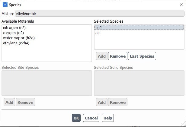

I want to adopt the CO2 gas in a specific volume within a larger domain by patching the value for CO2. When I use FLUENT's database for CO there is CO2 in the list but I don't want other materials to be solved cause it makes simulation longer. How can I only adopt one single gas in the species transport model? (note that the main gas in the domain is Air in my model and I am willing to model the rate of decay of CO2 from a volume to the main domain)

September 20, 2021 at 10:28 amRob
Forum ModeratorYou want to mix air and CO2 ? You just need two species in the mixture taking care that the bulk species is last in the list.

September 20, 2021 at 4:07 pmNimaNZ
SubscriberCould you please provide more details on what you're referring to? By main species and a tracer you mean you use species transport or not? I just apply one of the mixtures and put all other materials as zero and just give value to CO2 at the room volume. It's working but as it's solving transport equations for all other four materials, it increases the computational cost. That's why I want to reduce the number of materials in the mixture.
September 20, 2021 at 4:13 pmRob
Forum ModeratorYes, species transport. We may have water and water-tracer in a model or air and pollutant if we're looking at a plume dispersion. Edit the mixture template to remove species you don't want. Setting fractions as zero is wasting compute resource. Have a look in the tutorials (under Help) one is bound to cover combustion, just ignore the reactions bit to see how to edit the mixture.
September 21, 2021 at 10:20 amNimaNZ

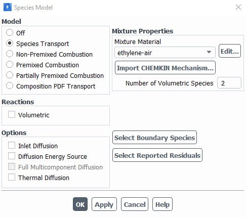

First of all, thanks a million for your help and patience, it is really appreciated and helpful. I finally managed to remove the species as followingI thought I should add air to be the last species otherwise it takes CO2 itself as the last species, is that alright?
Then because there is no reaction I set the species transport as followsI am not quite sure if this setting will lead to solving the following transport equation or not? as I couldn't find it in the theory guide!
You mentioned selecting the proper "diffusion coefficient", is it different from the Schmidt number we specify in the viscous model?

September 21, 2021 at 12:46 pmRob
Forum ModeratorThat looks about right. Diffusivity is set in the species mixture panel, and is separate from the turbulence setting. Chances are the system is sufficiently turbulent that turbulence will dominate mixing.
