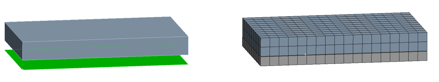

      peteroznewman, I tried using Adjust to Touch option for the model below. The surface body is given offset type of bottom, as shown the figure below. Gap between the surface body (marked in green) and bottom face of the solid body is 2.1 mm. I have given a thickness of 2 mm to the surface body.
      So the distance between the top most face of the surface body and the bottom face of the solid body is 0.1 mm. What if I use option adjust to touch? Will this top most face of the surface body will move by 0.1 mm only, or it will move the complete surface body by 0.1 mm, or it will make the surface body itself move 2.1 mm (so that it just overlaps with the bottom face of the solid body)?

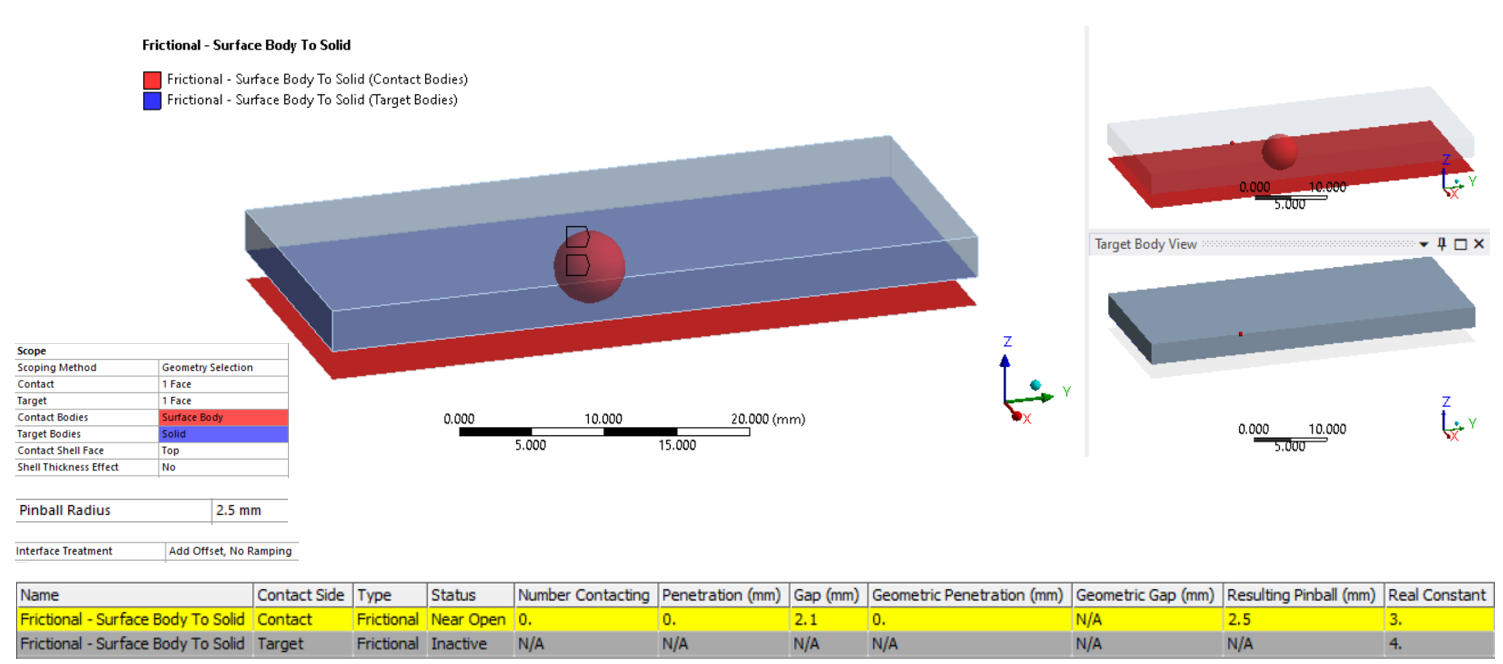

      peteroznewman, well I deleted the model because it was only an example. But just built it again, and here are the results.
      Surface Body below, solid body above. Gap between the surface body and solid body = 2.1 mm. Thickness given to the surface body (using offset type = Bottom) = 2 mm. The gap between the upper most face of the surface body and the bottom face of the solid body = 0.1 mm.
      CASE 1: (CONTACT = Given to Surface Body, TARGET = Given to Solid Body, Pinball radius = 2.5 mm, Interface Treatment = Add Offset, No Ramping, Target Shell Face = Top).
      The gap is still 2.1 mm, and not 0.1 mm (which you were signifying). Why is that so? A gap of 2.1 mm implies that the force transfer will not take place at the top most face of the surface body (which is offsetted by 2 mm), but infact will take place at the face (of surface body) where the original surface body is present (I mean at original location of the nodes of this surface body). Right? But this is something I don't want. I want the force transfer to take place at the 2 mm offsetted face of the surface body. Plus, I don't see any value for geometric gap, why?
      CASE 2: (CONTACT = Given to Solid Body, TARGET = Given to Surface Body, Pinball radius = 2.5 mm, Interface Treatment = Add Offset, No Ramping, Target Shell Face = Top).
      Again, the same thing. The contact is tracked but the gap is still 2.1 mm (and not 0.1 mm as you were saying). This confuses me why. What can I do to make the force transfer to happen at the top most face of the surface body which is offsetted by 2 mm. However, now I geometric gap as well. I don't know why do I see it now but couldn't see it in 1st case.
      Note that when the interface Treatment was set to 'Adjust to Touch', both the cases gave GAP = 0 mm ( (because the closest contact elements translates to close the gap). But how much amount they move? 0.1 mm, or 2.1 mm? I don't know.
      Rameez_ul_Haq
      The case you are studying, with a surface body on the opposite side from the contact, I never use. I either put the surface body in contact with the solid body, so I don't need an offset, or I have a surface body at the midsurface, then I turn on Shell Thickness Effect, and it automatically calculates the offset.
      You can use Offset (No Ramping) of 2 mm. I expect that will provide a 0.1 mm gap.
