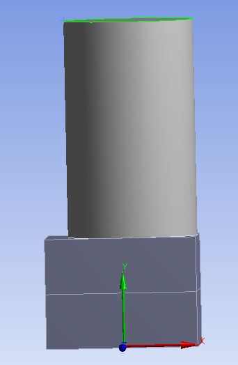

      Hello I would like to add a force to the bottom right corner of the model in the y direction. I would like the force to stop once the horizontal displacement of the top of the cylinder reaches a threshold in the -x direction.
      There may be other ways to achieve what you want. Here is how I would achieve your goal.
      Analysis Settings
         Auto Time Stepping, On
            Initial Substeps 10
            Minimum Substeps 10
         Large Deflection, On
      In the Solution Branch, insert a directional deformation plot using the horizontal coordinate direction and scope it to the top of the cylinder.
      After you solve, you will have tabular data for Time, Applied Force and Horizontal Deformation.  Pick the value of force when the horizontal deformation reaches the threshold.
      This assumes that the applied force is large enough.  If the horizontal deformation didn't reach the threshold, make it larger. If you want more resolution in the tabular output, use more substeps.

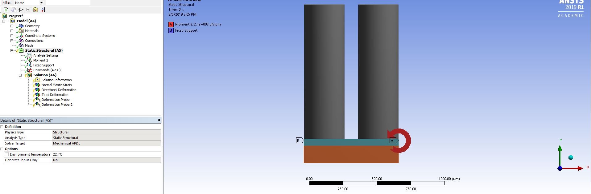

      Hello Sir,
      So I changed the model a bit to more accurately reflect my device. The moment on the right side will eventually cause the two pillars to touch. This is what I'm looking for. However I have not had much luck with enforcing contact (thus why I'm trying to use displacement). I have read a bit about parameterizing but cannot find a solid source. Ideally I would like to optimize the gap between the pillars for a given strain. But for now I would just like to increase the moment until contact is made (or the difference of displacement in the X is 0). I'm not exactly sure how to add a direct optimization component as you mentioned above. Thank you again for your time.
      Please attach your Workbench Project Archive .wbpz file after you Post your reply and I will try adding the Direct Optimization.
    • rdk9000
      Hello Sir,
      After looking around I found a great tutorial about direct optimization (
      ). It worked like a charm. Thank you very much for your help!
