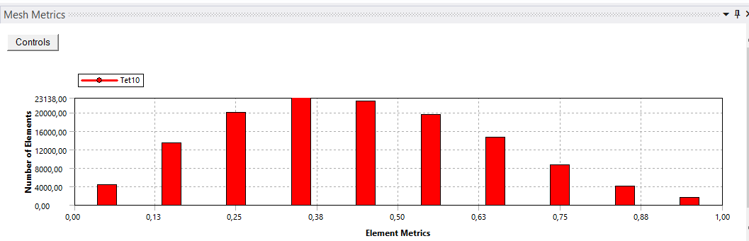

michutorres
SubscriberHi,nnow I am going to refine my mesh as someone told me that mesh quality skewness should be under 0.8 and orthogonality mesh quality should be higher than at least 0.15.nI clicked on Metrics Display and I can only see a graphic like below. Where can I check the exact value to see if my skewness is under 0.8 and orthogonality over 0.15?n

Amine Ben Hadj Ali
Ansys EmployeeYou can limit the graph and then click on the pivot / pillar to highlight the cells. However I recommend doing that in Fluent and rely on Fluent metrics.n -
March 22, 2021 at 10:41 am
michutorres
SubscriberHow can I do this in Fluent? Where is the option Fluent metrics?n -
March 22, 2021 at 11:49 am
Karthik Remella
AdministratorHi,nYou won't get a histogram plot like this in Fluent (not unless you are using Fluent Meshing). If you are working with Ansys Meshing, it is better you do this there. In Fluent, you will only be able to print the values of your mesh quality or plot a contour of your mesh metric. Look under Contour -> Mesh -> Orthogonal Quality and see if this helps.nKarthikn -
March 22, 2021 at 2:48 pm
Amine Ben Hadj Ali
Ansys EmployeeIn Fluent you rely on iso-surface or cell registers to show the cell with certain quality range. No histogram like in Ansys Meshing.n
