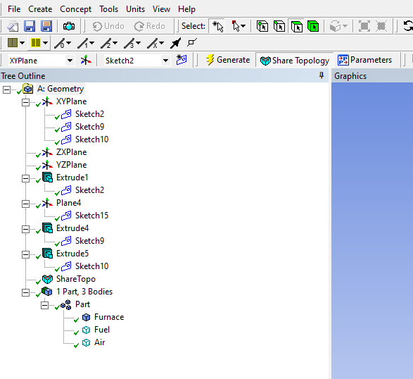

When I use this designmodeller for creating geometry in ANSYS WORKBENCH >> FLUENT >> GEOMETRY>> New DesignModeller,the interface is opening but I cant use Create Menu.
Under the Create >> Primitives >> All options are greyed out in addition to many other options.
What should I do to activate it ?

Forum ModeratorCan you check if you've already started a command and then not Executed it? I can't see the tree in your image.Â

Forum Moderator.Can you show what the tree looks like? If you have an incomplete command (ie didn't generate) you can't do much else until that's done.

Subscriber.Got it I had deleted the Part and share topology operations than able to insert primitzive objects.
Thank you Rob .

Forum Moderator.If you'd used the Share Topo command in the tree as opposed to making a multibody part and letting DM do it automatically it does turn off some geometry tools. It used to turn everything off which made things much simpler!
