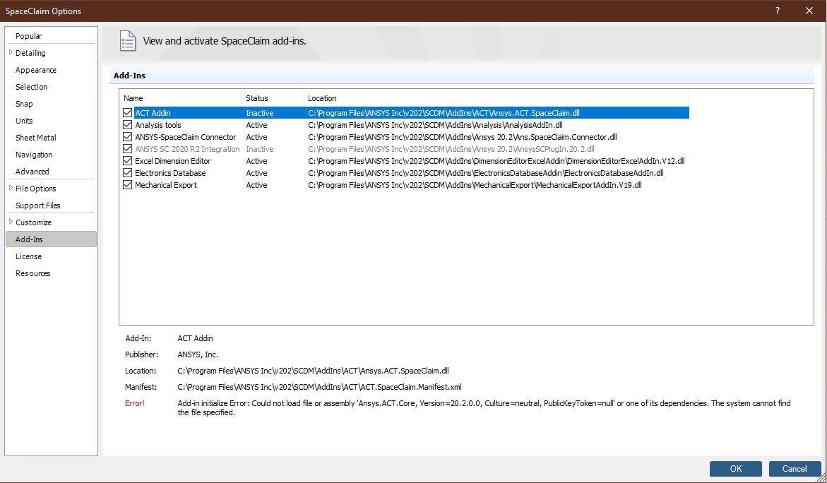

Did you encounter any error while installing SpaceClaim? Can you try uninstalling and reinstalling the software and see if that helps to resolve the issue? While installing, please ensure that you have first unzipped the installation files and you run the setup.exe in administrative mode.

SubscriberHi Naresh,
I installed the software with Administrative right. I will try again and let you know then.
I uninstalled and clean installed the software again with Administrative right. However, it does not fix the issue.

Ansys EmployeeHello Matt Madore
Do you have any suggestions to resolve this ACT addin issue?
April 26, 2021 at 10:49 am
ANSYS_MMadore
Forum ModeratorHuu Trong Luong can you share the text of your C:Program FilesAnsys Incinstall.log and install.err files?

SubscriberMatt Madore Sorry for the delay!
I removed the software and reinstalled it with Admin right. Here are the log files.

ANSYS_MMadore
Forum ModeratorAre you still seeing the ACT issue with the new install? Have you tried deleting the %APPDATA%Ansysv202 and v211 directories?

trong.luong
SubscriberMatt Madore I still have the ACT issue. I did not delete  %APPDATA%Ansysv202 and v211 directories. Should I delete them before or after installation?

SubscriberHi Matt,
I would like to resume this topic. Is there any update or guidance to fix this yet?
