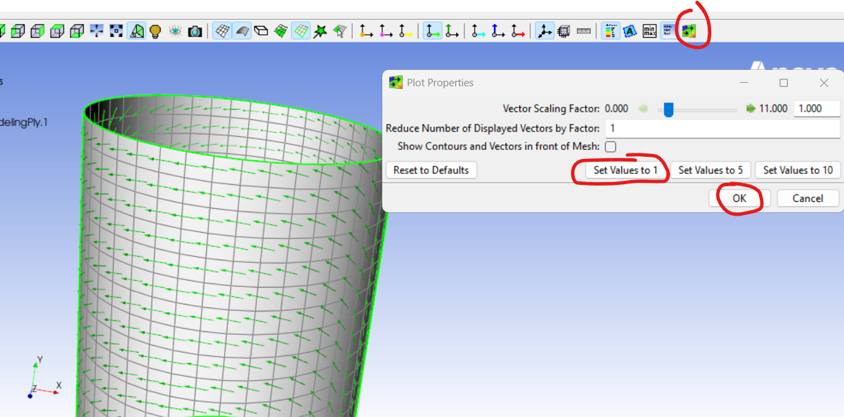

      I am working with ANSYS ACP 2024 R2 and have a problem with the visualization of shell normals and fiber orientations on a cylindrical shell.

      When I display the shell normals and fiber orientations, the arrows appear only on approximately one half of the cylindrical surface. On the remaining part of the cylinder, very few or no arrows are shown at all.
      The cylinder is a continuous surface and I would expect the normals and orientation vectors to be displayed uniformly around the entire circumference.

      I have attached a screenshot showing the normals (green) and orientation vectors (magenta).

      Use plot properties and set values to 1 to plaot an error from each element . See if it helps
      If the model is solved in Mechanical, you can right click on solutions and insert coordinate system and plot element triads. This will be element coordinate system. You can plot this for each ply.
