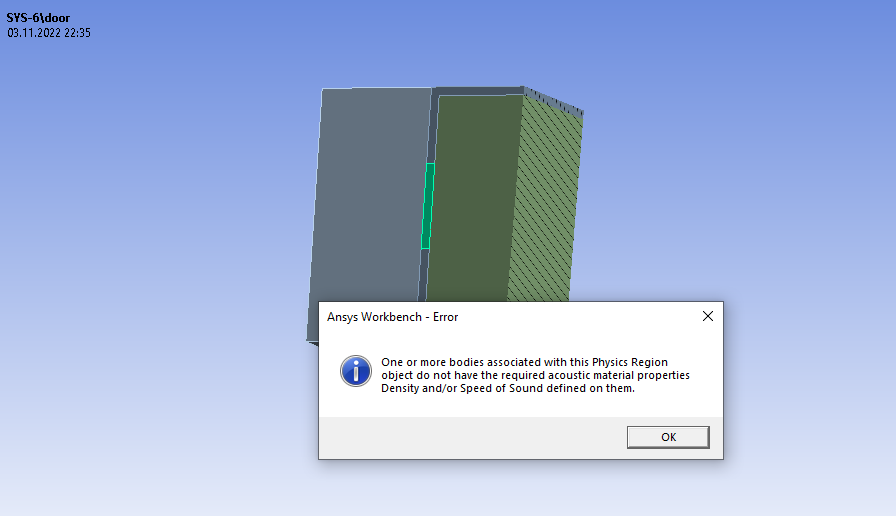

      when carrying out the acoustic analysis, I cannot add any material other than air to my components. I am trying to do an acoustic analysis in a room and want to add a different material for walls, doors etc.
      The following information appears when adding other material.
      What am I doing wrong? How to change it?
      Thank you for your help, best regards.
      You must add the two material properties: Density and Speed of Sound, before you can assign that material to an Acoustics Region.
