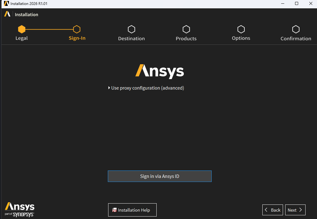

Forum ModeratorHi Gurkeer,
The issue might be caused by the default TCP port 8080 which is probably being blocked somehow on the network.Identify a port number that is not reserved by any other application running on the network, you can direct the installer to use that port number for logging in.
For example, if you have TCP port 50000 open on the network, You can use the following command on command prompt to login by communicating over that port:
"AnsysInstaller.exe" -login_port 50000
