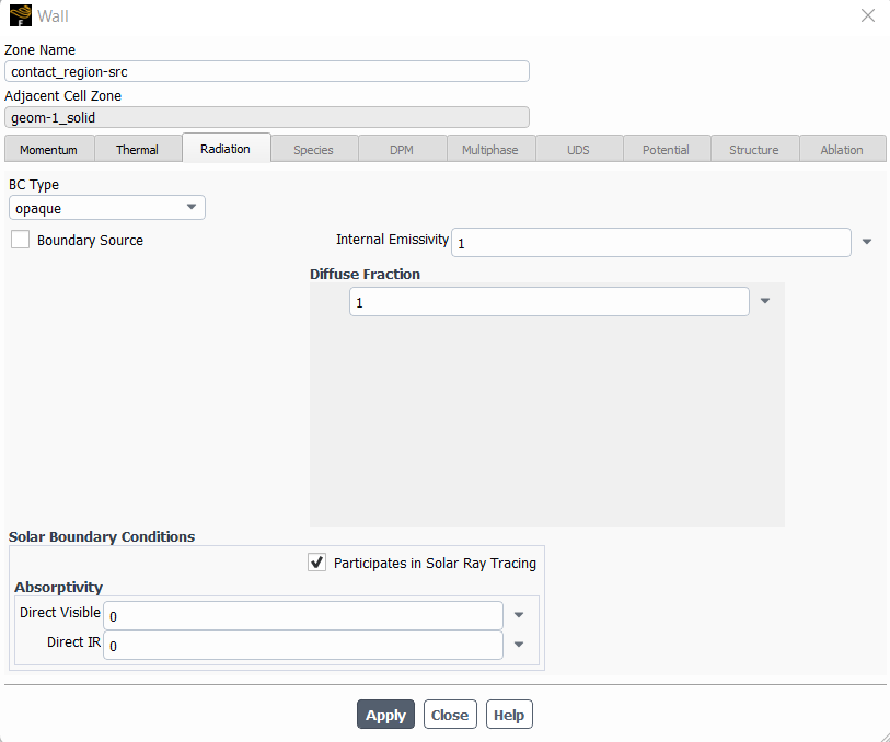

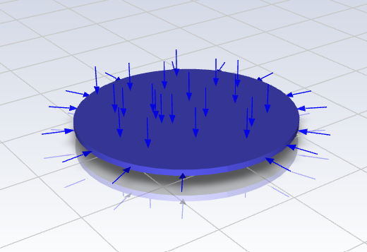

      I have a thin plate with the bottom surface receiving solar flux, and the other surfaces being fully transparent and the inside of the geometry being air with very low (1e-5) density.

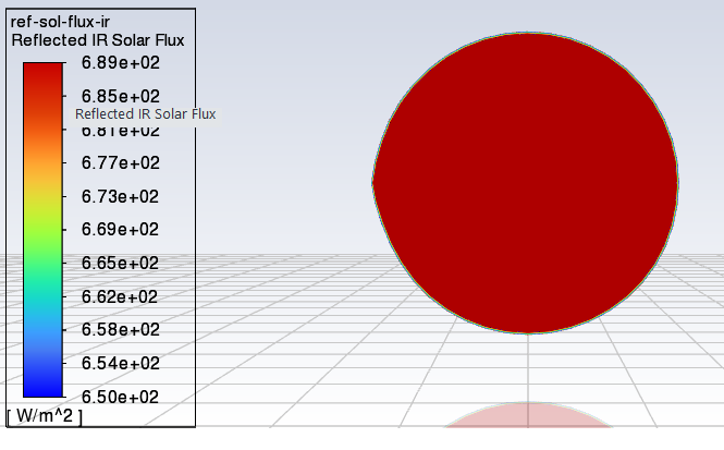

      This bottom wall was set to 0 transmissivity and 0 absorptivity for this case, so it was expected that the solar radiation coming in (1377 W/m2) would be split between reflectivity in the IR and visible, 688.5 W/m2, which occured.

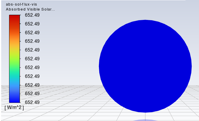

      However, the absorbed visible solar flux map was also showing a value, which was unexpected. The absorbed IR was as expected, 0 W/m2.
      Does anyone have any reasons this may be occuring? Thank you.

      Can you please check your settings again?
      Please note absorbed visible solar flux is not evalueted for opaque surface.

        Thank you for your reply. Sorry, I am confused: opaque surfaces do not have absorbed solar flux?
    • li can
      i have the same confusing , how  to set opaque surface condition to absorb solar flux ?
