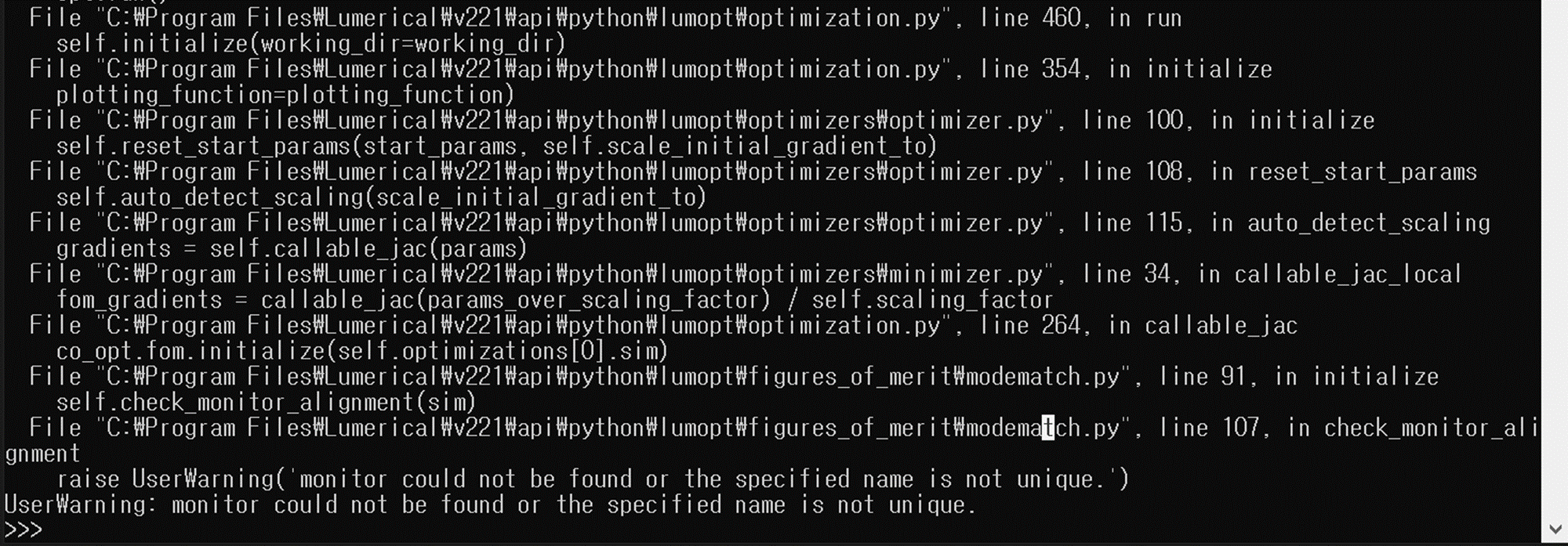

      Hello everyone,
      I have 2 questions related to topology optimization;
      1) is it possible to use another source like gaussian or plane rather than mode source? if yes, how?
      2)when I try to run an optimization which involves 2 different script files, because I have to use different source locations, I get the following error. how can I fix it?
      Thank you.
    • Taylor Robertson
      1) It is possible to use a Gaussian or plane wave source, but the figure of merit needs to be the power in mode. This is a bit of an aside, but the adjoint source needs to be a mode source, which is not fundamental to the adjoint method, but the way lumopt is implemented is limited to guided mode photonics.
      2)I think when using co-optimization you can use two separate scripts if needed to create two different set-ups, or specify the sources separately.
      To make two files with different set-ups simply pass differnt scripts to the opt class, using the script_name parameter, for the second use the source_name parameter.
      See Optimization section
