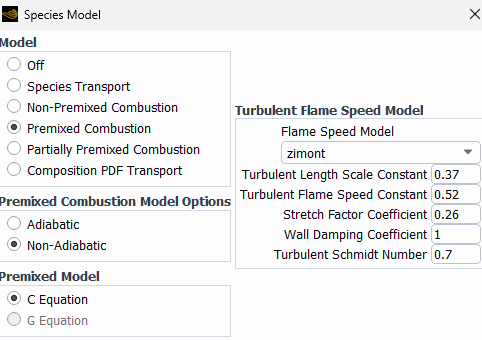

      Its premixed combustion. I use the default premixed setup with c equation and zimont model. My mixture is ch4+air and later i will try to add hydrogen. The model is at atmospheric conditions and it contains a combustion chamber with adiabatic walls(maybe later i will consider the wall heat exchance effects). For the inlet conditions, i took velocity and turbulence profiles from an experiment based thesis. I already run the steady rans models and results were satisfiying for a steady rans result.

      The flame position is greatly affected by laminar and turbulent flame speeds, so I would consider looking into turbulent flame speed calculation before turning off the default turbulence production limiter.

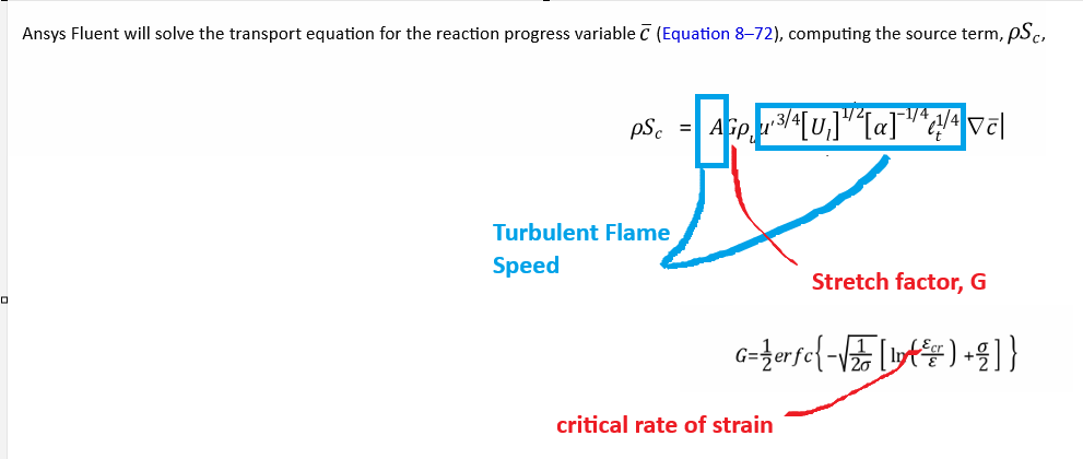

      The higher the turbulent flame speed, the closer the flame will sit to the burner ... (to a point)  The premixed model allows a constant laminar flame speed value to be specified. Laminar flame speed is used to calculate turbulent flame speed You can also adjust the Critical Rate of Strain:
      If the critical strain rate is too high, the model will not predict extinction even when it should physically occur. (The default setting is for no extinction.) For lean premixed methane/air flames, typical critical strain rate values range from 3000 to 8000 s^-1.
      Critical strain rate is used to calculate the Stretch factor, G, which multiplies the turbulent flame speed in the calculation of the progress variable source term.  Below is how turbulent flame speed stretch factor and the progress variable source term are related:
      I hope this helps.
