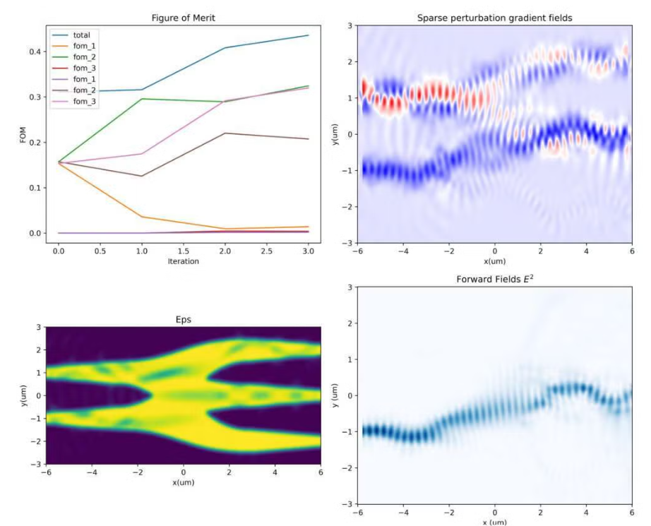

      We've written the following code to attempt the inverse design of a 2x3 MMI device using Lumopt. The goal is to achieve equal power at the three output ports when two mode light sources enter through two input ports respectively. However, we've noticed that the actual FOM curve doesn't trend towards a gradual reduction in insertion loss. Why is this the case? Could you please provide me with professional advice and assistance? Thank you!

    • George Patsamanis
      thank you for reaching out to us.
      I can provide you with some overall feedback according to your target design.
      When two sources with the same mode are present at the same time, the algorithm will optimize the geometry based on the initial (fixed) phases of the two sources.
      You would need a total of 3 figure of merits, one for each output monitor. The “target_fom” can be 1/3 for all foms. The wavelength can be the same for all foms.
      You don’t need more than one optimizers. The number of “opt” should also be three, one “opt” for each “fom”.
      As the final optimizable parameter, you can have the: opt = opt1+opt2+opt3.
      You can use the 1×2 splitter topology optimization example as your template and make your modifications there.
      Inverse Design of a Splitter Using Topology Optimization – Ansys Optics
      In this case, make sure to remove the symmetry, remove the bend waveguide, add one more input and one more output, and setup the fom and opt correctly. You will also need to pay attention when setting up the XY size of the simulation, so that it is the same in both .lsf and .py files.
      You may need to go through some trials and errors, but when the scripts are all well set you will then have the fom trend converging as expected.
      I hope this helps you with your studies.
      George

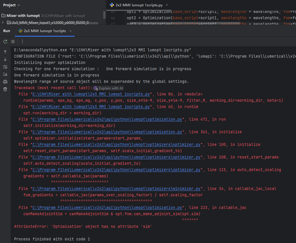

      2. Optimizer Error in v242
        You mentioned that multiple optimizers are unnecessary. This worked in my previous version (v202), where one optimizer handled 3 opt entries. However, when I ran the identical file in v242, the simulation failed with the error shown in the figure, prompting me to use multiple optimizers. Could you explain why this error occurs and how to resolve it correctly?
