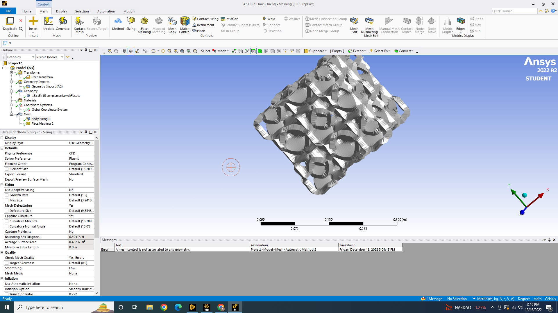

SubscriberDelete the mesh controls and try to mesh. Add any mesh controls you need.
December 19, 2022 at 4:11 pm
Alex Yang
SubscriberThank you for your reply Peter,Â
I couldn't generate a mesh even without any controls as it simply states "The mesh generation did not complete due to poor quality elements or incorrect input. Please try meshing with another mesh method or different mesh options".
December 19, 2022 at 5:52 pm
peteroznewman
SubscriberI suggest you bring the geometry into SpaceClaim and on the Repair tab, use the Extra Edges and Extra Vertices buttons to repair the geometry.
